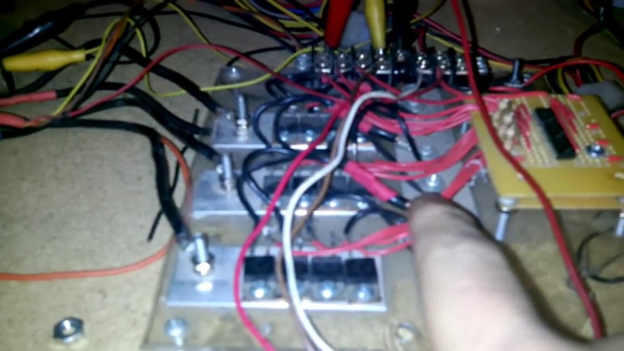

I've built myself a bldc motor out of an alternator and put together a tachometer using the arduino to monitor the rpm of the motor using one of the hall effect sensors that I built into the motor. The problem is that the arduino is not giving accurate measurement.
here is the video of the set up if you would like to see what I'm talking about:
you can see what I'm talking about at 5:40.
I've basically got it counting every edge that comes by the hall effect sensor inside of a second, multiplying that by 60, then dividing that by seven (seven poles on the rotor in a alternator.)
The information I get back is not correct, in that before it hits 1000 rpm, it shows between 0 and 3000, and before 6000 it does the same thing. so it basically counts from 0 to 3000 then switches to 1000 and counts up to 3000 again, then switches to 6000 and continues counting. this is when the motor is running. When just hooking it up to a button, it will count around 150 rps for one button press. I thought Maybe it was a bounce issue, but counting 150 from 1 button press is a lot of bounce.
Anyway here is the code, thanks!

Okay so I tried the reworked code you gave me, and it looked good up until the 6600 mark again. The rpm was bouncing around alot too. The only thing I did from your rework to what I uploaded was dividing the rpm by 7 before it prints. 7 poles...
How many pulses per second do you think the arduino can catch? it gets to about 775 max and then starts counting down like it's missing. I need a real tach ha ha.
Well, I've gone and minimized it as much as I can come up with, thinking there might be to much code, but it won't go over that 6500-6600 RPM cap, just starts counting down. Only thing I can figure is the hall effect sensor is pulsing faster than the arduino can catch, but even that is only 770 hz at 6600 rpm. Don't arduinos run quite a bit faster than that? I was thinking of trying a decade counter to divide the pulse by seven and see if that takes the load off. Any other ideas? Could the LCD be in the way some how?

So I went and added the Decade counter to divide the hall effect sensor output by 7. Basically the hall effect sensor clocks the decade counter, then the decade counter outputs to the arduino on the sixth output, and resets on the seventh so the arduino just has to multiply that input by 60 and print it. However it still won't go over 6600, it continues to count down once it gets there. I figure if it was the speed of the sampling, this would have fixed it since a decade counter can generally handle a clock speed of 5 mhz or atleast one mhz, and I'm only talking 770 hz. any clues?
If any one is wondering why it needs to be divided by seven, it's because the hall effect sensors are built into the alternator, and the rotor has 7 poles, so a full rotation would show as 7 pulses from one of the 3 hall effect sensors.
Helps appreciated!
Why are there 3 hall effect sensors? Which one(s) are connected to the interrupt pin?
1 hall effect sensor for each stator winding. The alternator has three sets of stator windings, so there is one sensor per winding. Each sensor watches the rotor and pulses the winding it's positioned for. Since 7 pulses from any one of the sensors will equal one rotation, I just picked one.
What is the part number for the hall effect sensor you are using?
A3144
datasheet:
