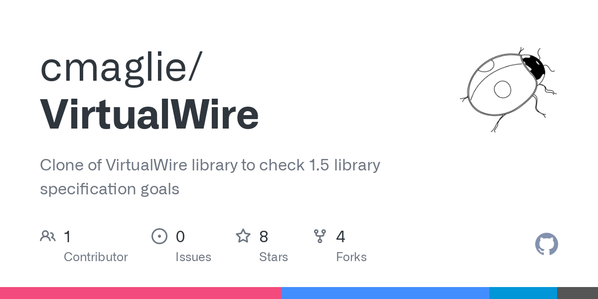

It appears you are using this library:
This was only a proof of concept made by one of the Arduino developers for a proposed Arduino library structure which was not used in the end. So you won't be able to use it.
I think your best bet will be to uninstall that version of VirtualWire and then replace it with the original VirtualWire, which you can download here:
http://airspayce.com/mikem/arduino/VirtualWire/
Or perhaps you will be better off to heed the notice there:
END OF LIFE NOTICE
This VirtualWire library has now been superceded by the RadioHead library RadioHead: RadioHead Packet Radio library for embedded microprocessors RadioHead and its RH_ASK driver provides all the features supported by VirtualWire, and much more besides, including Reliable Datagrams, Addressing, Routing and Meshes. All the platforms that VirtualWire supported are also supported by RadioHead.
This library will no longer be maintained or updated, but we will continue to publish it for the benefit of the the community. Nevertheless we recommend upgrading to RadioHead where possible.
