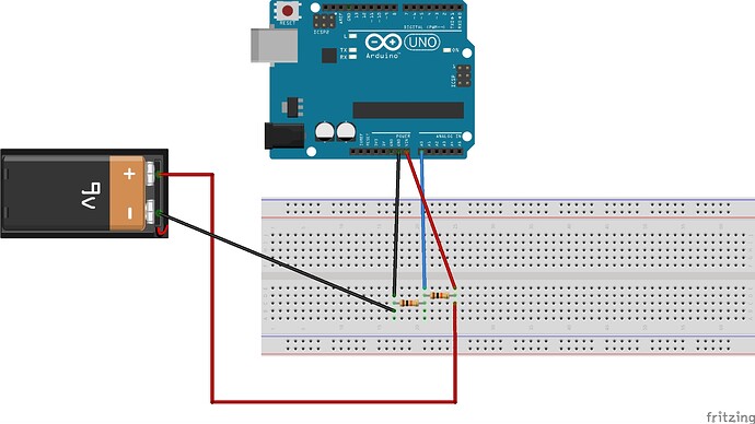

Currently I am using a 9V battery and two 10k ohm resistors as a voltage divider to reduce it to 4.5V (I would have preferred to divide it to 5V but I don’t have the correct value of resistors.) I also want the same battery to power the Arduino. Before I begin programming, is this wiring correct?
Just tried to attach an .JPG but it didn't work. Best way to insert an image?
That will work, but a 9V battery won't last long.
Thanks for the replies. Here is the image file I tried to upload earlier. Is the wiring correct if I am to power the Arduino with a 9V battery and measure the voltage?
Yes, wiring is correct.
That will work if the battery is between 6 and 10 volt.

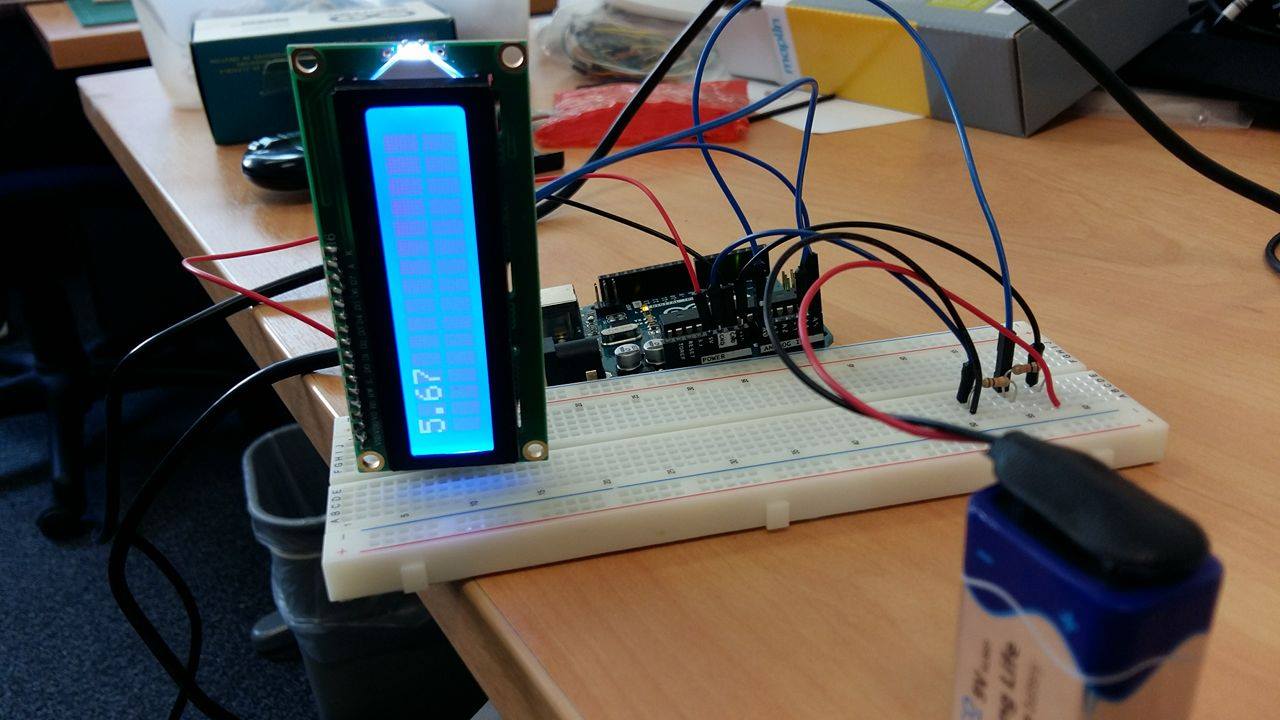

Here is the set up.
Also I am now using an LCD screen do display the real time volt of the battery.

Setup seems ok.
Still waiting for the voltage on A0.
Double-check the resistor values.
Leo..

Great! However the next problem is when I disconnect the USB power source from the laptop and power the Arduino only using the battery the battery (By using a wire from the battery, before the first resistor to Vin, the value become strange and doesn't look as if its in real time. Demonstrated in the image below.
The value has dropped drastically from 8.04 - 5.68. And when I voltage across the two resistors it is 7.23 dropping 0.01 quit frequently. This isn't in sync at all with 5.68?
Also when the Arduino is powered by the USB, the LCD value increases and to verify this is related to the battery, when measured using a multimeter, the batteries voltage increases too. Can anyone explain why this happens?
jremington already said in post#3 that a 9volt smoke alarm battery won't last long.
The Arduino and the display (backlight) might add up to 100mA.
Most 9volt batteries can't keep up with that current.
Unexpected things happen below 6volt.
Leo..
