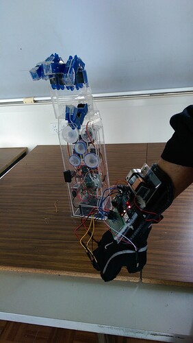

As promised attached is a picture of my project :slight_smile:
just got to tweek the fingers a bit to make them bend more and it should be all sweet.
