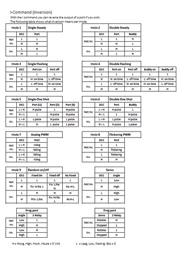

also, here is combination (see attach.) of output states on pins, for leds etc, coils, servo, etc. on master arduino

one of the option is output port which changes state of pin depending on servo position (in this case level crossing barrier), maybe this is easier solution.
servo rotates -output pin goes low = sample is played one time until servo reaches desired position
servo stopped -output pin goes high = sample stops
any option will be welcome.
how does servo rotating affect output pin?
myDFPlayer.play(1);
does play() return when audio is complete. if you, continue to call play() while input LOW
here is link for software manual , page 23 http://www.globalvisuals.nl/downloads/mardecUK.pdf
in table , servo option for output pin
