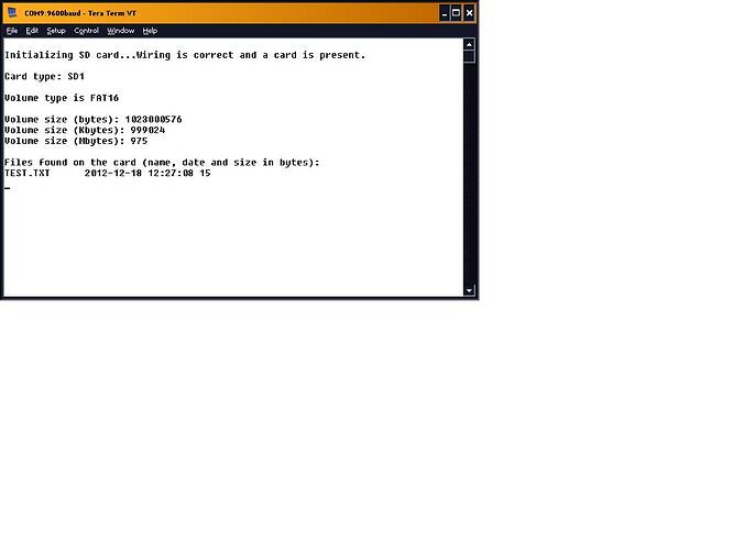

Below is a temperature logger which writes to an SD card.

My earlier like is a serial-logger, that is absolutely everything written to the serial port is captured to the SD card. This can subsequently be read by any modern PC.
