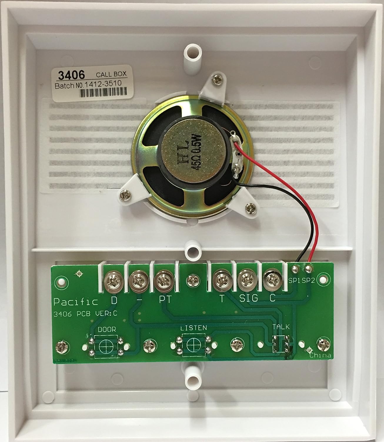

I'm a software guy who doesn't know much about the hardware side of things, so I'm looking for some guidance on a project. I live in an apartment that has an ancient intercom / door buzzer and I'm trying to make it a bit smarter.
The in-unit piece is a Pacific Electronics 3406 6-wire unit (see here for a clear shot of the PCB). This connects down to a TekTone PK-543 in the basement which is where all the wires hook up. The PK-543 also amplifies the audio from what I've been able to gather, but I've not been able to find much information about how the TekTone PK-543 works internally. All of the documents I've found just indicate how to wire it up, and very few of what I've found covers the 6-wire model at all. The only picture for the 6-wire I've been able to find is also attached, although it's wired up to an AF-1000 (which, from what I gather has basically been replaced by the PK-543).
Here's how it works from a workflow perspective:
  • First, a person outside the building presses the button for my apartment. This comes through the "SIG" line (which is only to my apartment - all the other wires are common to all apartments), which runs through the speaker, and plays a "warble" sounds through the speaker.
  • Next, I press the Listen button to hear the person at the front. This connects "T" to the speaker and I hear them talking. If I talk they can't hear me.
  • Next, I press Talk to speak back to them (using the speaker itself as a microphone). This connects the "PT" line to "-" and "T" to the speaker. In this mode I can still hear them talking and they can hear me. I presume that "PT" somehow indicates to the amplifier unit in the basement that it needs to stop blocking the audio out from my unit.
  • Lastly, I press Door to buzz them in, which connects "D" to "-" and buzzes the door.
I've done research and come across a bunch of similar projects, however, they're almost exclusively focused on buzzing the door which is trivially done by using a relay to connect "D" and "-". I'd like to do more than that. Ultimately, the goal is for me to be able to buzz in deliveries when I'm not at home, but also be able to listen and talk (with the Arduino effectively receiving/sending PCM) so I'm not blindly buzzing people in. I can handle the Arduino software side of things and I know that I need an ADC/DAC. The thing I'm struggling with is how to wire things up, specifically around what voltages are involved and all of that to ensure I don't fry the Arduino or vice versa.
A few questions:
  • Putting a multimeter between "D" and "-" I read between 11-12V DC that is fairly constant (if I switch to AC it fluctuates wildly from like 0.2V to 1.0V). Same reading for "PT" to "-". In most of the projects I've seen people have used SPDT relays for connecting those. From what I've gathered those are "safer" because things are truly isolated, but can I use a MOSFET or something else to switch those? The relays are kind of large and I'd like to avoid them if possible, especially since it seems like they're more generally useful for switching like 120V AC rather than 12V.
  • I found a layout for a relay circuit that claims to detect the buzz here. Can some please explain like I'm five what that circuit is doing? He also claims the buzzer is 24V pulsed DC, but I don't see 24V anywhere, not even across SIG and C. Would I need to tweak that if it's 12V or something else?
  • The multimeter reads a fairly constant 18mV DC across "T" and "C" and if I switch it to AC it fluctuates wildly from like 0.5V to around 5V. If I press the Talk or Listen button and do the same, it looks like the DC fluctuates down to 0 and the "center" of the AC fluctuation drops as well, but I don't really see anything that correlates with loud sounds. It just looks random. I know the ADC/DAC on whichever Arduino I go with will have voltage limits, but how do I know what range they should be in? Is it 18mV? What's up with both the AC and DC component? Do I need to isolate the Arduino from the signal?
  • Can someone explain how things are working when Talk is pressed and the speaker in my unit (45ohm, 0.5W) is acting as both a speaker and a microphone? How would that work with me wiring it up to the ADC and DAC?

Thing is, hacking an existing device is actually a very advanced electronics project, especially when the schematics are not available - that's reverse engineering which in some ways is harder than engineering. When you build something yourself, you can control the complexity and limit the components to what you have documentation for. Also you own the liability for any damage. That is a better way to begin learning.
You have said that if you are talking to the person wanting to enter, you can also hear him/her talking at the same time. That simultaneous 2 way conversation using a single audio element (loud speaker) would be difficult to implement. Can you verify your statement?
I guess the use of the listen button is optional. You could simply press the talk button and it would cancel the door ring tone and open the audio channel. From the circuit picture, it looks like the talk button also closes the listen button circuit.
If I understand you correctly, you want to extend the the apartment unit to a cell phone or something similar. I guess it would be possible to initiate a call to a cell phone on detecting the door ring tone, and relay the audio channel, via a cell phone module. You’d also have to interpret keypad presses on the cellphone and relay these to apartment unit. Any Arduino that you used would not be processing audio signals, it would simply be switching audio channels (with a relay or an equivalent switching circuit), so there would be no role for a dac or adc as far as I see.
To detect the door ring, I’d probably use a opto coupler based circuit, but would first check what the signal looked like with an oscilloscope.
In general, using relays to duplicate the function of push to make switches is the easiest approach, because you don’t have to understand too much of the circuit you are connecting to.
However, the whole project is not trivial and the main issues to solve, as I see it, are (1) identifying the door ring tone, (2) conditioning the audio signals so these are compatible with a cell phone module, that is designing an audio gateway between the two systems (probably isolated with say a 600 Ohm audio transformer) (3) interpreting the cell phone keypad (DTMF tones) to duplicate the functions of the buttons on the apartment unit (listen, push to talk, open) and (4) joining it all up.

6v6gt: You were correct. I tested this afternoon and when "Talk" is pressed you cannot hear someone talking at the front door, so the audio really is unidirectional.

The challenge for me, instead, is learning how to (a) electrically isolate the audio in/out from the intercom and the Arduino and (b) determining the voltage range that both the ADC and DAC should operate in for everything to work correctly. Your suggestion to get more data here was a good one since the multimeter I have is insufficient for the task, so I'm going to buy an oscilloscope so that I have a better idea of the system.
While getting an oscilloscope, get an isolation transformer so the scope ground lead on the probe does not provide a mains ground to the intercom.
