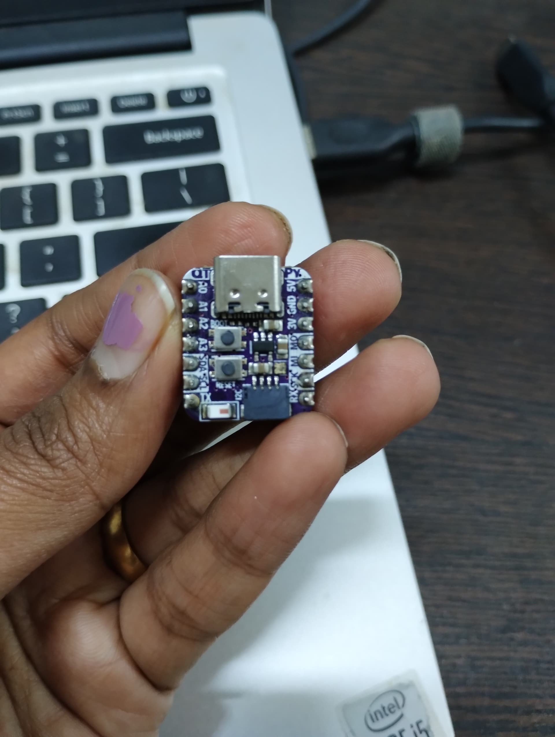

Are you using the following ESP32-C3 Dev Board?
adafruit QT PY ESP32-C3
it looks similar

Please, post the picture of your ESP32-C3 Board.

This is the pin configuration of QT PY ESP32-C3. In that case, let me try with 0,1,3,4 and 5
Thanks for the pictures. It is indeed similar to ESP32-C3 of post #2. I am investigating the operation of the SPI Port.
