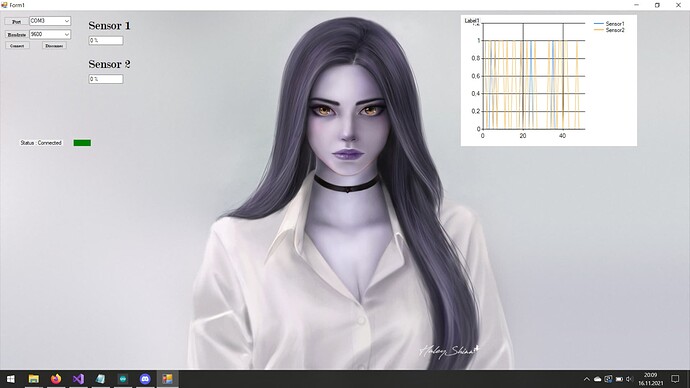

As you can see in this picture, I managed to get the readings into a textbox:
As said, I want to take this further, but I'm a beginner end need some help with the basics.
As I undersatnd, VB now reads what my COM-port recieves from the Arduino.
First question; how to i split the values from A0 and A1 so i can show them in diferent text-boxes?
Question 2; Can i get this into a progressbar/diagram or anything else to make it more pro-looking?

The above is very basic but provides a good foundation to build on, once you capture the readings in the textboxes you can move on to add a graphical dial (a user control) that displays percentage.
Thanks alot for the reply!
As said, I'm in the process of learning, and tried to understand the code you posted..
Loads of errors, and don't know where to start..
If it's not a big problem for you, would you mind copy my exsisting code and put in what you wrote?
Anyways, thanks alot for answering my post :slight_smile:
"Loads of errors, and don't know where to start" does not really tell me anything so it is hard for me to point you in the right direction.
The objective is to create a simple protocol where we place data in a bracket of a header and a terminator and VB is set up to recognise the data in it's brackets. The header is a simple word, either "Sensor1," or "Sensor2," (no spaces) this is followed by the data, either "percentageHumididy" or "percentageHumididy2" and finally the terminator which is CR and produced by using the "Serial.println" instruction. Notice the difference between print and println.
So the first sensor would transmit a string like this "Sensor1,the actual data value here"CR. The comma that follows the header is used as the marker to split the string into header and data which is then placed in an array that I call txtarray. We now end up with two strings from one txtarray(0)="Sensor1" (comma has been removed) and txtarray(1)=the value of percentageHumididy.
The visual basic code I posted is set up to capture this protocol, your Arduino code needs the following modification.

Thanks again!
Got it working! :smiley:
Thanks alot for the help @sumguy ,really appriciate it :slight_smile:
Can you tell us what the problem was and how you fixed it.
The time out value is too high drop it down to 50 or 100
SerialPort1.ReadTimeout = 1000
Your next steps would be to research a few things to make a better inteface, buttons to open and close the serial port, combo boxes to display baud rates and available com ports.
If you need some help on how to design a dial as a visual percentage indicator then say so and we can give you a start with that.
Not shure exactly what i did to get it working, but think the problem was that i forgot to add

I allready got some projects with "buttons to open and close" "baud-rates" and "available COM ports", so I'll take a look at that..
I would like to get it to work with "circular_progress_bar" and maybe a chart of some kind, so if you could tell me where to start, please do :slight_smile:
Fonts and other stuff i will manage myself :slight_smile:
So, this is my code now, with working scan port and baud rate :smiley:

Anyone wanna try to explain how I get these values to a chart?
I don't know a great deal about MSChart but I believe it's a subject you are going to have to research on more appropriate forums, there is a great deal of info out there. To get you started I can help with something simple that allows you to alter values and play around with a template that assumes the values come from the Arduino once every second for a duration of five minutes.
Snippet 1 is code that resets the Arduino and clears the PC serial buffer giving you a clean start.
SerialPort1.DtrEnable = True
        SerialPort1.Open()
        SerialPort1.ReadExisting()
Snippet 2 is an addition to your existing DisplayData sub routine and passes the data to the chart.
Dim chartvalue As Integer
If txtarray(0) = "Sensor1" Then
                TextBox1.Text = "Sensor 1 value=" & txtarray(1) & " %"
                Integer.TryParse(txtarray(1), chartvalue)
                Chart1.Series("Series1").Points.Add(chartvalue)

Great, exactly what i was looking for :slight_smile:

I also understands the basics now, here's my late-night design:
I will set this post as solved now :slight_smile:
Thanks
VB CODE:

@sumguy
Is there a easy way to get the X-axis to show realtime (DateTimeNow) (dd-mm-yy hh:mm:ss)?
You were really helpfull to get the project working, and now I'm stuck with this issue.
Think maybe this is where I have to make some changes?
