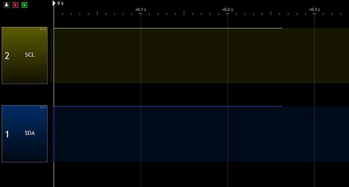

If check Both code . i could see Serial Monitor printing Data . But when i connect SDA/SCL line it wont respond to slave device.
I have attached waveform for reference.

I can't understand the problem, MCP7940N does not work? Is it found by I2C scanner? Elaborate please.
I have connected my hardware as shown in attached image . refer schematic. I am trying use some test code from website to make it work
I have tested RTC device like Ds1307/PC8563 device where i could able to read and write data into Serial monitor or Seven segment display. i used logic analyzer to capture i2c signal.Where for above 2 i2c device i could able to get slave response
In this also i am trying to do the same thing . but when i see communication side it working but in actual bus it not coming.
When i go through datasheet of microchip , they are recommend to use 2.2K resistor. Arduino CKt uses 10k Resistor in SDA/SCL/MFP line
  1. weather my hardware is proper?
  2. Is there code like DS1307 where i could write and read time & capture signal like DS1307 devices
    code example for MCP7940 are more complicated.
  3. it say it found address but when i connect logical analzer it fails to read response. check SDA/SCL line for reference.
As suggested previously, your first test when having problems with an I2C device is to use the Arduino I2C scanner sketch to see if the device is detected.
There's a discussion of a multi frequency one here that I've used in the past.
Yes my mcp7940 is detected.i could make it work.
But I would like to understand .How to read the data from i2c device format. With above code it not working
But I got some library where they and with 7f and devide by 10 to get answer.

        //     PORTAbits.RA4=1;
    if(segno==8) {
        PORTA=0X00;
        PORTA = Seg6; //DP2 First Segment
        // PORTAbits.RA5=1;
      unsigned int bcdtodecimal(unsigned int bcd)
    unsigned int decimal;
    decimal = (((bcd & 0xF0) >> 4) * 10) + (bcd & 0x0F);
    return decimal;
      unsigned char OverFlow;
void ISR_Routine(void) {
    if(PIR0bits.TMR0IF==1) {
        PIR0bits.TMR0IF = 0;
        count= count+1;
        OverFlow=OverFlow+1;
        if(count>=10)
            Flag_Update=1;
            count=0;
             LED=!LED;
void I2C_Initialize()
    //  SDA_DIR=1;
   // SCK_DIR=1;
    SSP1STAT = 0x80;
    SSP1CON1 = 0x28;
    SSP1CON2 = 0x00;
    SSP1ADD  = 0x19;// intially 19
    SSP1CON1bits.SSPEN = 0;
void I2C_Master_Idle (void)
  while ((SSP1STATbits.RW) || (SSP1CON2 & 0x1F)); // Transmit is in progress
void I2C_Master_Wait (void)
    while(!SSPIF);                              //wait till SSPIF flag is set
    SSPIF=0;
void I2C_Master_Start(void)
  I2C_Master_Idle();
  SSP1CON2bits.SEN = 1;  // Initiate start condition
  I2C_Master_Wait();
void I2C_Master_Restart(void)
  SSP1CON2bits.RSEN = 1; // Initiate repeated start condition
  I2C_Master_Wait();
void I2C_Master_Stop (void)
  SSP1CON2bits.PEN = 1; //Initiate stop condition
  I2C_Master_Wait();
void I2C_Master_NAK (void)
    SSP1CON2bits.ACKDT = 1; //Set as negative acknowledgement
    SSP1CON2bits.ACKEN=1;  //Initiate negative acknowledgement signal
    I2C_Master_Wait();
void I2C_Master_Write (uint8_t data)
    while (1)
        SSP1BUF = data;    //Write data to SSPBUF
        I2C_Master_Wait(); // Wait
        if (SSP1CON2bits.ACKSTAT) // Check for ack
            I2C_Master_Restart(); // Restart if nak
        } else break;
uint8_t I2C_Master_Read (void)
  SSP1CON2bits.RCEN = 1;  // Enable reception
  while (!SSP1STATbits.BF) {}
  SSP1CON2bits.RCEN = 0; // Disable reception
  return SSP1BUF;  // Read data
void MCP7940_Write (uint8_t dev_addr, uint8_t reg_addr, uint8_t reg_data)
    I2C_Master_Start();  // Send START condition
    I2C_Master_Write((dev_addr << 1) & 0xfe );// Send address with R/W cleared for write
    I2C_Master_Write(reg_addr);  // Write reg_addr
    I2C_Master_Write(reg_data);  // Write reg_data
    I2C_Master_Stop(); //Stop condition
    __delay_ms(200);
uint8_t MCP7940_Read (uint8_t dev_addr, uint8_t reg_addr)
    I2C_Master_Start();           //Start condition
    I2C_Master_Write((dev_addr << 1) | 0x01); //7 bit address + Read
    uint8_t temp = I2C_Master_Read(); // read data t
    I2C_Master_NAK();           // Send NAK
    __delay_ms(200);
    return temp;
void main(void)
    // Initialize the device
    SYSTEM_Initialize();
    INTCONbits.GIE=1;
    INTCONbits.PEIE=1;
   // I2C_Initialize();
    I2C1_Initialize();
    MCP7940_Write(MCP7940_ADDR, ADDR_SEC, 0x0 | OSC_ON); // sec to zero BUT osc on
    MCP7940_Write(MCP7940_ADDR, ADDR_MIN, 0x59); //  min to 59
    MCP7940_Write(MCP7940_ADDR, ADDR_HOUR, 0x12); //  hour to 12
    while (1)
        sec = MCP7940_Read(MCP7940_ADDR, ADDR_SEC);
        min = MCP7940_Read(MCP7940_ADDR, ADDR_MIN);
       if(Flag_Update==1) {
            SetSeg(min >> 4,4);
            __delay_ms(5);
            SetSeg(min & 0x0f,3);
            __delay_ms(5);
            SetSeg(sec >> 4,2);
            __delay_ms(5);
            SetSeg(sec & 0x0f,1);
            __delay_ms(5);
            Flag_Update = 0;    //ready for next update
