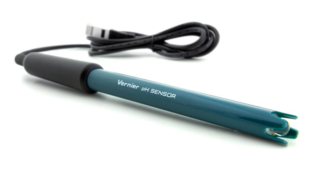

Here you go:
it is an analog device
data for values http://www2.vernier.com/booklets/ph-bta.pdf
pinouts :smiley:
http://www.vernier.com/probes/specs/pinout.html
Have you looked at the circuit at [/Building the Simplest Possible pH Meter • 66pacific.com? It's as simple a pH meter as you can make. You can just add another op-amp to increase the voltage and/or the polarity of the output. The IC Op-Amp Cookbook by Jung has lots of good circuits for that.
