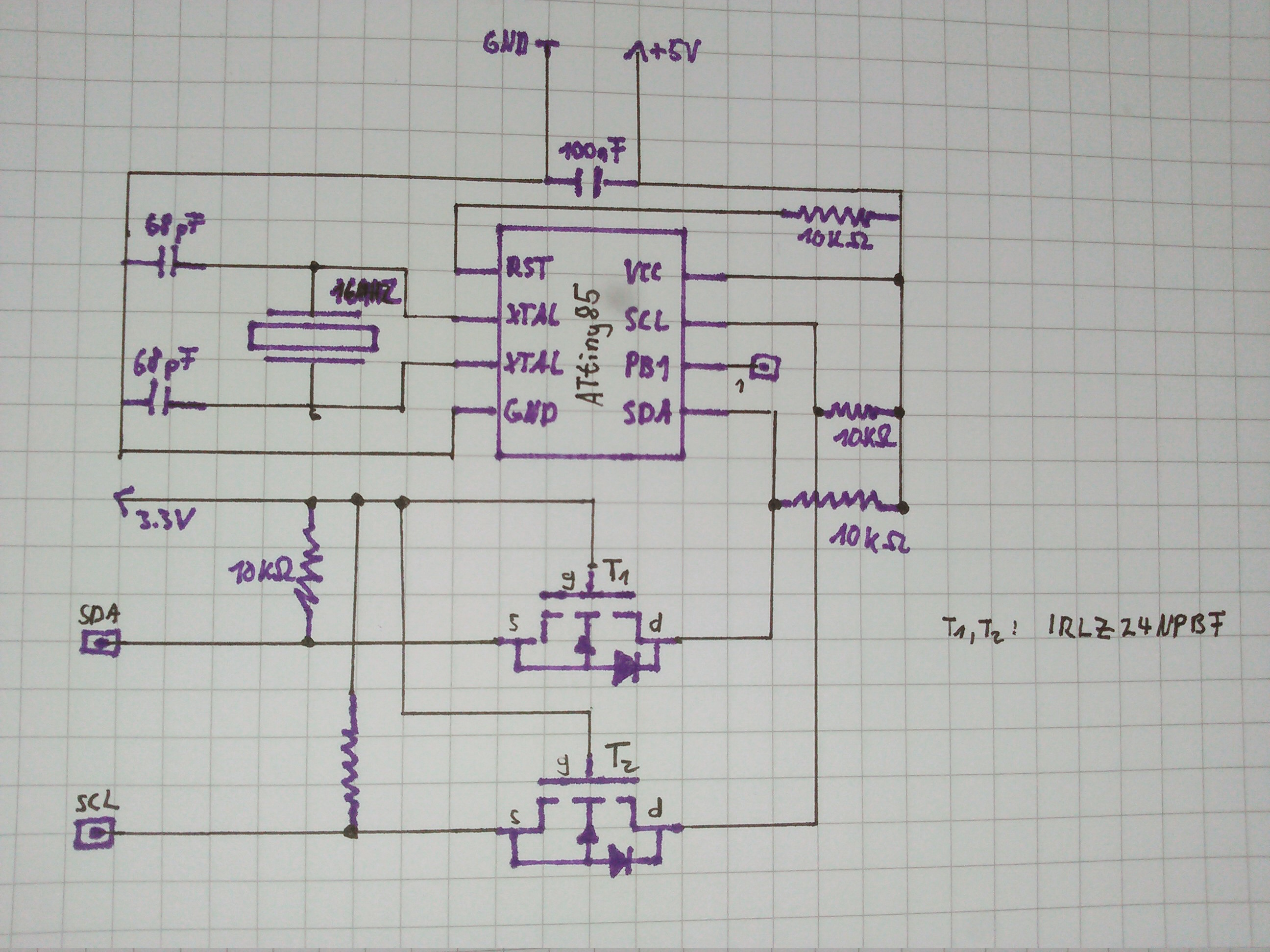

For a Project I need to interface a Due with an ATtiny via I2C, and I just can't get it working at all.
As for the ATtiny Core, I'm using ATtinyCore
I2C on the ATtiny is realized by tinyWireS
Let's consider this simple example given by Ladvien

As for further Information, the ATtiny utilizes a external 16Mhz crystal, the level shifting is done by two MOSFET's. I do know that the level does work, since I have absolutely no problems with an Arduino Uno Compatible C-Control board run with 3.3V logic.
The shematics can be found in an attachement, of course the tiny and the Due share the same ground and I already tried different pullup resistor values and Wire as well as Wire1 to no result so far. Since I'm relatively new to electronics I have no Idea how to progress from here, and my main point is trying to understand what is actually happening and if somebody can help me learn I'm eternally grateful.
