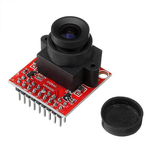

It does NOT have mosi or miso I/o.
It has a SCCB interface.
My question: How can I interface with an Arduino mega 2650?
Searched the web for a few days, lots of examples for the ov7670 but only a few for the ov2640, and then not even the same ov2640.
Some of the ov2640's have 20 pins,mine has 18 pins.

I am still not completely clear why some cameras have a miso(master in slave out) and mosi(master out, slave in) i/o but others do not have them.
My one only has scl,sda,dclock and d0-d7 i/o.
Probably different way to get the data?
