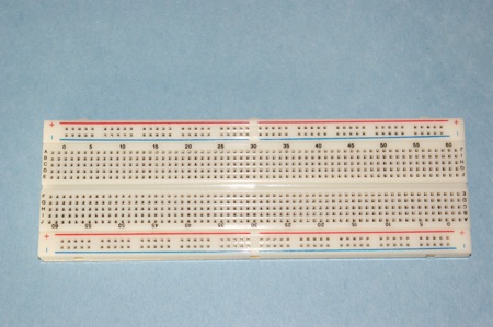

  1. If you're using a breadboard and using the supply rail across the top or bottom, and it is the type that are not connected all the way across, that messes up some folks. Split power rails. You can tell if it's that kind of breadboard by the break in the blue and red stripes on the board.
