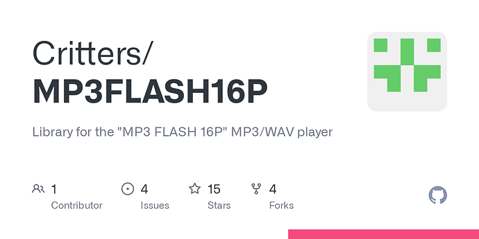

I use SoftwareSerial basically because Critters lib uses it. I wrote my own code, but the lib generates obviously the same error.

Post a GitHub link to that library.
Pretty simple, the same interrupt vector can't be defined more than once in the same code.
ooops, forgot to paste:
The lib doesn't. It simply tries to use an interrupt vector that has already been claimed. For completely obvious reasons that is not permitted.
Use hardware serial and the problem will not only go away, the code will work as well or better than the original, and even be smaller.
There's not much to that library. I'd rewrite it so that the class constructor accepts a reference to an object of the Stream class. Then you could pass it a HardwareSerial or SoftwareSerial object depending on the board in use. You could even then post a GitHub Pull request for the author to include that improvement.
MP3FLASH16P_RPH.cpp (2.7 KB)
MP3FLASH16P_RPH.h (838 Bytes)
I modded the lib to use only Serial1, and added a fadeOut() method. (initiate with fadeOutStart([duration in ms]), then put fadeOut() in the main loop).
