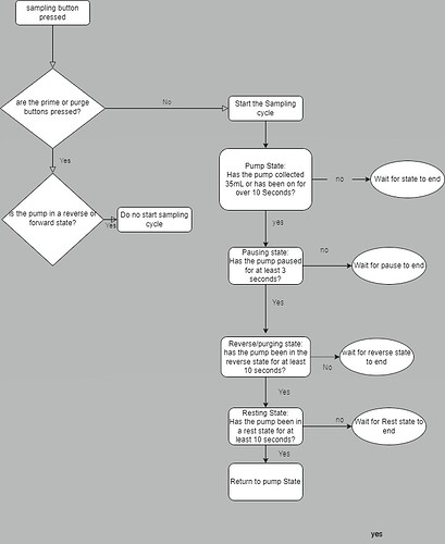

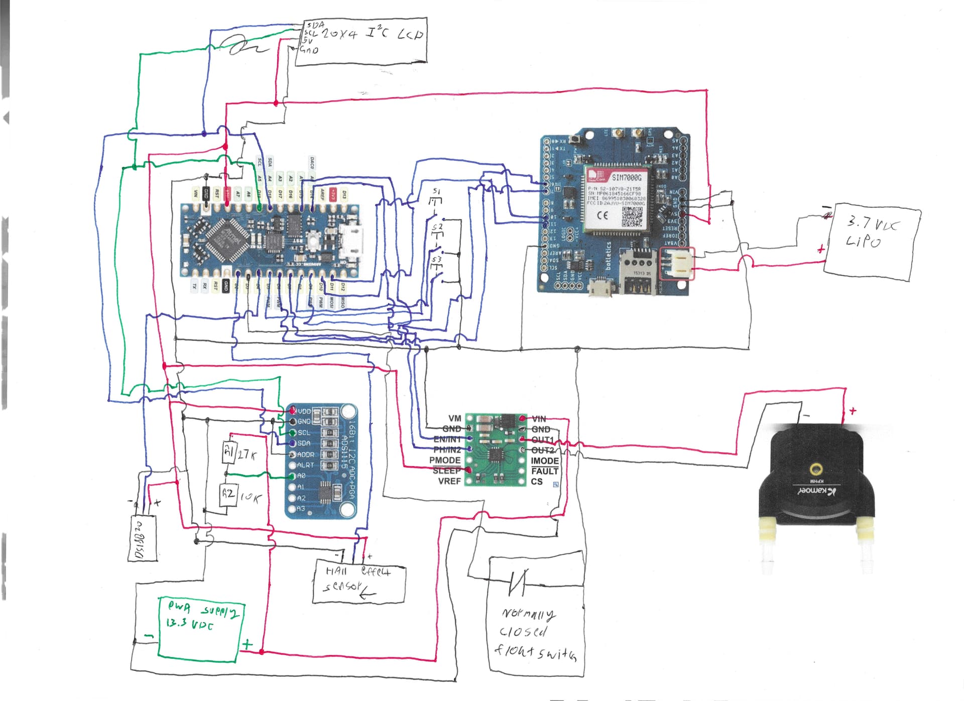

Over the past few months I've been developing a portable autosampler meant to collect a certain amount of liquid Before moving on to the next state as describe in the following flow chart:
I've received much assistance from this forum in creating this prototype and implementing IoT functions which allow for remote monitoring of the sampler with key details such as volume collected, battery life, temperature, and also implementing SMS alerts which would allow for the operator to know when the containing is full, when the battery level is low, and when temperature is below freezing. I have successfully implemented all this functions into a single sketch on an Arduino Nano EVERY with mixed success. I would like to now ask the community for further assistance in fixing some minor bugs. here a few of them:

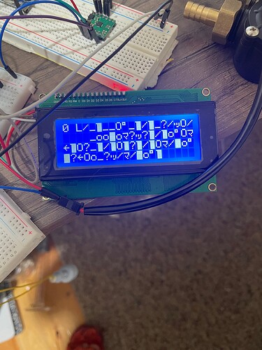

  • Temperature and battery percent on LCD blink for first few seconds, then LCD data is corrupted
  • When pump is started, battery percent drops below 20% and sends battery low SMS
  • When alert SMS messages fail to send, entire sketch is blocked because of delay
  • When GPRS fails to enable to post data to dweet, entire sketch is blocked because of delay
One of the issues I see are related to the SIM module and its use of delays for its vital functions. When the sketch calls for these functions, it blocks all other functions which is not beneficial. The sampler is supposed to run without depending on SIM module functions, which is not possible at the moment. I've made an attempt to replace all the delay functions in the loop with millis() functions, but other functions such as the enabling of GPRS to post data to dweet and freeboard, as well as the SMS alerts block critical functions of the sampler. For example, if the SIM module is stuck trying to post data to dweet and cant enable GPRS, it wont allow for the start of the sampling protocol.
This problem I think perhaps I can solve with a capacitor, but when I start the sampling protocol and the pump is activated, the battery charge drops below the "LOW" threshold, triggering the low battery SMS. Going off of what the datasheet for the pump states and what I see on my meter and power supply, the pump draws 0.44 amps. I'm attaching the full sketch and also a rudimentary schematic which includes the components I'm using:

  lcd.begin();                           // screen size
  lcd.setCursor(0, 2);
  lcd.print("Batt [%]:  ");
  lcd.print(percent);
  lcd.setCursor(0, 3);
  lcd.print("Temp [F]:  ");
  lcd.print(tempF);

  switch (state)                        // Check which state we are in.
    case OffState:
      while (digitalRead(primeBtnPin) == released)             // Prime button being pressed?
        PumpForward();                                         // Turn on the pump.
      while (digitalRead(purgeBtnPin) == released)             // Purge button being pressed?
        PumpReverse();                                // Reverse the pump
      startMillis = currentMillis;      // Keep resetting the start time of the pumping sequence.
      pumpOff();
    case PumpState:
      if (totalMilliLitres > 350 || currentMillis - startMillis > 10000)         /// did we collect 35mL? if not, go to next stage after 45000 millis
        state = PausingState;
        PumpForward();
      lcd.setCursor(0, 0);
      lcd.print("PUMP ");
    case PausingState:
      if (currentMillis - startMillis > 14000)   // Have we been in this state too long?
        state = ReverseState;

Pumps and other inductive loads will take far more than average current during startup.
So there are a few possibilities:
  • Get a better power supply
  • Wait with sending low battery message until battery is low for 30 seconds or so
  • Put pump on separate power supply (I think it already is).
  • add a big capacitor to reduce the dip
It would be useful to make a schematic where + is on top, gnd is at bottom and information goes from left to right (sensors left, controller in middle, lcd and pump on right). You can make that in software, but pen and paper will also do.
Perhaps it is better to make more than one drawing as it will not easily fit on one page.
The power supply im using simulates the power supply the device will be powered by, which is a single 12 volt LiFePO4 5AH battery, so I cant change that yet. I did add a capacitor on the motor driver for the vin and gnd, but unfortunately I fried the Nano EVERY and don't have a replacement. I do have a couple ESP32's I'm trying to use instead. the sketch loads onto the ESP32 fine and the wiring has been changed to reflect the ESP32 pins, but for some reason the main loop of the sketch wont run. I read that its because the ESP32 uses millis() differently and the delays in the loop are handled by millis(). I can only get "hello", currentMillis, and "test" to print on the serial monitor but nothing else will. Whats strange is that when I load the blink without delay example onto the ESP32, it runs fine and prints out the millis

  if (digitalRead(samplingBtnPin) == released)
    if (state > OffState)                              // Are we already in a pumping cycle?
      state = OffState;
      state = PumpState;
  delay(200);                         // Small delay to debounce the button.
  Serial.println("test");

      lcd.clear();
      lcd.setCursor(5, 0);
      lcd.print("Rate: ");
      lcd.print ( pulseCount); // resets flow rate to 0
      lcd.print (" L/m");
      lcd.setCursor(0, 1);
      lcd.print("Vol:");
      lcd.print(vol);
      lcd.print(" mL");
      lcd.print("Vol:");
      lcd.print(vol);
      lcd.print(" mL");
      lcd.print(percent);
      lcd.print(tempF);
    case OffState:
      pumpOff();
    case PumpState:
        PumpForward();
      lcd.print("PUMP ");
    case PausingState:
        pumpOff();
      lcd.print("REST ");
    case ReverseState:
      if (currentMillis - startMillis > 22000) // Have we been in this state too long?
        state = RestState;//state++;
        PumpReverse();
      lcd.print("PURGE");
    case RestState:
      if (currentMillis - startMillis > 32000 )  // has it been 15 minutes AND the float switch is still open?
        state = PumpState;
        startMillis = currentMillis;            // Reset the start time of the pumping sequence.
        totalMilliLitres = 0;                  //reset totalMilliLitres so it can start counting up from 0 again
        pumpOff();
      lcd.print("REST ");

When I use the Pump and Purge buttons to manually operate the pump, there is no observable voltage drop. the voltage drop only happens when when its running the pumping protocol.
I added a 50V 100 uf capacitor to the motor controller VIN and gnd pins, but doesn't seem to do anything. I added an additional capacitor at VIN at R2 and GND at R1 with no change.
      lcd.print(flowRate);
      lcd.setCursor(6, 1);
      lcd.print(":L/min");
      lcd.print(totalMilliLitres);
      lcd.setCursor(6, 2);
      lcd.print(": mL");
    case OffState:
      pumpOff();
    case PumpState:
      if (currentMillis - startMillis > 10000)         /// did we collect 35mL? if not, go to next stage after 45000 millis
        PumpForward();
    case PausingState:
        pumpOff();
      Serial.println("PAUSE!");
      lcd.print("PAUSED! ");
    case ReverseState:
        PumpReverse();
    case RestState:
        state = PumpState;
        pumpOff();
      Serial.println("REST!");
      lcd.print("RESTING!");
  /***************************SMS ALERTS***************************************************/
  if (buttonState == HIGH && lastButtonState == LOW || vol > 300 && vol - flowMilliLitres <= 300) {
    opened = false;
    lastButtonState = buttonState;
    FullSMS ();
  if (tempF < tLimit && cold == false) {
    ColdSMS ();
    cold = true;
  else if (tempF > tLimit + 2.0 && cold == true) {
    cold = false;
  if (percent < bLimit && bat == false) {
    batSMS ();
    bat = true;
  /***************************SMS ALERTS END***************************************************/

the first and very importat advise is to understand that
all looping
must be done by one single loop which is void loop() ITSELF
all and if I write ALL then I mean ALL EACH AND EVERY other functions must work in a quickly jump in / jump out manner
using zero while-loops, using zero-for-loops
If I write zero I mean ZERO.
This means your code will be able to be responsive to everything all the time.
If a reaction is really done then depends on the coded if-conditions.
You are already using a state-machine but your while-loops inside the states dis-able the resposniveness.
the basic principle is instead of using while-loops like
    case OffState:
you have a second state-machine for pump forward / backward inside the function manualMode()
    case OffState:
      manualMode(); // on pressing button forward / reverse switch pump to forward / reverse if no button is pressed switch pump off
    if (condition_to_leave_OffState == true) {
      state = PumpState; // or whatever state you want
As I don't know the exact conditions that must be fullfilled to leave the OffState I named the condition "condition_to_leave_OffState"
best regards Stefan
I soldered a pair of ceramic 0.1uF on the negative and positive terminals of the DC motor to the DC motor body, instead of the ADS1115 and the DC motor sharing common power terminals, I isolated the power and ground wires going into the motor driver and placed a 25V 100uF capacitor between the power and ground wires, placed another 25V 100uF between the power and ground rails on the breadboard from which the ADS1115 gets A0, placed a 16V 100uF capacitor the voltage divider and A0 with the negative side of the capacitor going to ground, placed a 25V 100uF capacitor between power input and R1 with the negative side of the capacitor going to ground, and twisted the power and ground wires going from the motor driver to the DC motor, voltage drop is virtually gone!
Which is why even professional programmers sketch their requirements on paper in a diagram-view. Multiple ways to approach this logical thinking process:
State diagram - Wikipedia
Thinking before coding really is a time saving methodology.
      state = OffState;
      state = PumpState;
  int adc0 = ads.readADC_SingleEnded(0);
  float battVoltage = ads.computeVolts(adc0) * dividerRatio * calFactor;
  float battVolt = battVoltage * 3.7;
  int battmV = (battVolt * 1000) + 30;
  Val = battmV;
  lcd.print("B%");
  lcd.setCursor(3, 3);
  lcd.print(percent);
  lcd.setCursor(7, 3);
  lcd.print("TEMP:");
  lcd.setCursor(13, 3);
  lcd.print(tempF);
  if (percent < 100) {
    lcd.setCursor(5, 3);
    lcd.print(" ");
  if (percent < 10) {
    lcd.setCursor(4, 3);
    lcd.print("  ");
      lcd.setCursor(5, 1);
      lcd.print(vol);
      lcd.print(": mL");
    case OffState:
      if(primeBtnPinHasBeenPressed = true) {
        state = PrimeState;
      if(purgeBtnPinHasBeenPressed = true) {
        state = PurgeState;
      while (digitalRead(resetBtnPin) == released)
        resetData();
      pumpOff();
    case PrimeState:
      if (digitalRead(primeBtnPin) == pressed)
        state = OffState;
          manualMode();
    case PurgeState:
      if (digitalRead(purgeBtnPin) == pressed)
        state = OffState;
          manualPurge();
    case PumpState:
      if (totalMilliLitres > vLimit || currentMillis - startMillis > 6000)        /// did we collect 35mL? if not, go to next stage after 45000 millis
        PumpForward();
    case PausingState:
      if (currentMillis - startMillis > 9000)   // Have we been in this state too long?
        pumpOff();
    case ReverseState:
      if (currentMillis - startMillis > 16000) // Have we been in this state too long?
        PumpReverse();
    case RestState:
      if (currentMillis - startMillis > 20000 && (digitalRead(buttonPin) == LOW))  // has it been 15 minutes AND the float switch is still open?
        state = PumpState;
        pumpOff();

void manualMode() {
  digitalWrite(DRV8876_IN1_PIN, HIGH);  // comment is obsolete code epxlains ITSELF Turn on the pump (forward).
  digitalWrite(DRV8876_IN2_PIN, LOW);
  //  Serial.println("PUMPING!");
  lcd.print("PUMPING!");
void manualPurge() {
  digitalWrite(DRV8876_IN1_PIN, LOW);  // comment is obsolete code epxlains ITSELF Turn on the pump (forward).
  digitalWrite(DRV8876_IN2_PIN, HIGH);
  lcd.print("PURGING!");

I change FullState to this:
   case FullState:
    if(Threshold < vol && ThresholdLimit == false)
     ThresholdLimit = true;
      if (ThresholdLimit == true ||  (digitalRead(buttonPin) == HIGH))
       state = OffState;
       Serial.println(state);
     state = PumpState;
and now the serial monitor displays ThresholdLimit change from false to true by displaying
22:18:13.208 -> THRESHOLD REACHED300
but it still wont return to OffState, it just keep going to PumpState. What am I doing wrong?

        state = PurgeState;
And as a second thing
your code still has while-loops which are blocking
you should organise your whole code to be non-blocking
you can control everything by a state-machine
Making a variable global is simply done by declaring it outside all
functions above all functions.
If you did not yet know what global scope is:
how many hours did you spend trying this / trying that?
I guess many hours. You should invest a few hours into learning ,ore basics
and investing a few hours to re-organise your code to work consequently with statemachines where each and every detail works in a quickly jump_in / jump_out-manner
I started writing a tutorial about that but it is not yet finished
