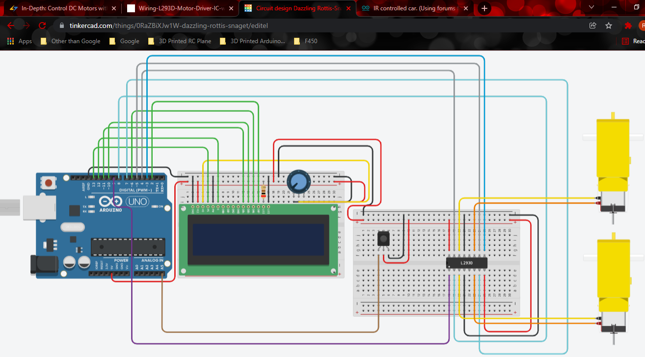

Hey guys, this is my first time using Arduino forums so if I'm doing some mistakes or posting in a wrong section please forgive me. Anyways, I want some help regarding my project. I'm trying to build a car using IR sensor which has a 16*2 LCD display. To test the project I used LEDs since I was not able find geared 5V DC motors, it was working as I wished it to. Later when I found my motors I hooked them up as I hoked up my LEDs previously but once I use my remote to use my car it doesn't work, it is almost like it freezes.

How is the car powered and how are the motors connected to the Arduino ?
Are you using a PP3 9V battery by any chance ?

Currently I have to buy a battery so I'm powering my project through the USB cable used to upload the code to Arduino. Also, I'm attaching the schematics of my project. If something has to be changed please do tell.

What is driving the motors?
(Correct answers do not include the words "the I/O pins")

If you are asking am I using a L293D driving shield or not, that I'm not. Also, in the message after you asked me "What is driving the motors?", do you wanna say that instead of using String variable I should directly write the sentences in the code?
Are you saying the motors are connected directly to the I/O pins?
Absolutely.
Preferably using the F() macro, so the string literals remain in flash, where they belong.
Yes, the motors are connected directly to I/O pins, since, I don't have L293D driving shield.
I'll try this out immediately.
Fix that first (or preferably something less antique), and let's hope you haven't damaged the Uno.
I have previously built an obstacle avoiding car using the same geared 5V DC motor and without using L293D driving shield, that was like a year ago, and I have build several projects after that, the board is working fine till date. Will me not having or using L293D damage my Arduino UNO? I have accommodated your advice regarding the String variables, there seems to be no change.

Don't connect motors to I/O pins; they're not designed for it.

Since I haven't got the L293D driving shield, I guess I'll have to dump this project. :smiling_face_with_tear:

I would, before you damage any more of your hardware.
Anecdote: A few years ago, I was working for a mobile phone manufacurer.
I had on of those teeny, tiny ERM motors that makes your phone vibrate. It was maybe 5mm or so square, and 15 - 20 mm long, and in an idle moment, I hooked it to a bench supply at its rated voltage.
It drew two and a half times the maximum current for an AVR pin.

Need your help friend...
I somehow got access to L293D Driver IC and hooked it up with the motors according to the schematics given below. Also, I connected the 16*2 LCD and VS1388B IR receiver sensor in a new way then the previous diagram I had shared.

What am I doing wrong? Everything seems about right as it can be. Please help and sorry if I'm troubling yaa.
