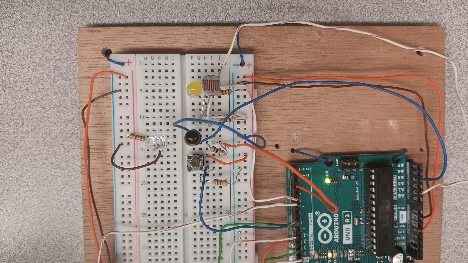

We've been stuck on this issue for a while now. Basically, we have an IR base pair -- an emitter and a phototransistor -- that is supposed to detect motion. Here is the code.
pinMode(A3, INPUT);
pinMode(2, INPUT);
int sensorValue = analogRead(A3); // change A0 to your sensor pin
Serial.println(sensorValue);
However, everytime we run the code and make changes, numbers on the console display as either only 0 or 1 (from digital) or 1023 (from analog), and are not actually responsive to motion close to the sensor.
It is more helpful to take a picture of a hand drawn wiring diagram carefully labelled. The picture you posted is incomplete and probably misleading.
BTW, who is 'we'
That looks like a kit you wired up. what kit? As @LarryD pointed out, your resistor has both ends in the same row of holes (e.g. tied together) so isn't doing anything. Most definitely wired wrong.
