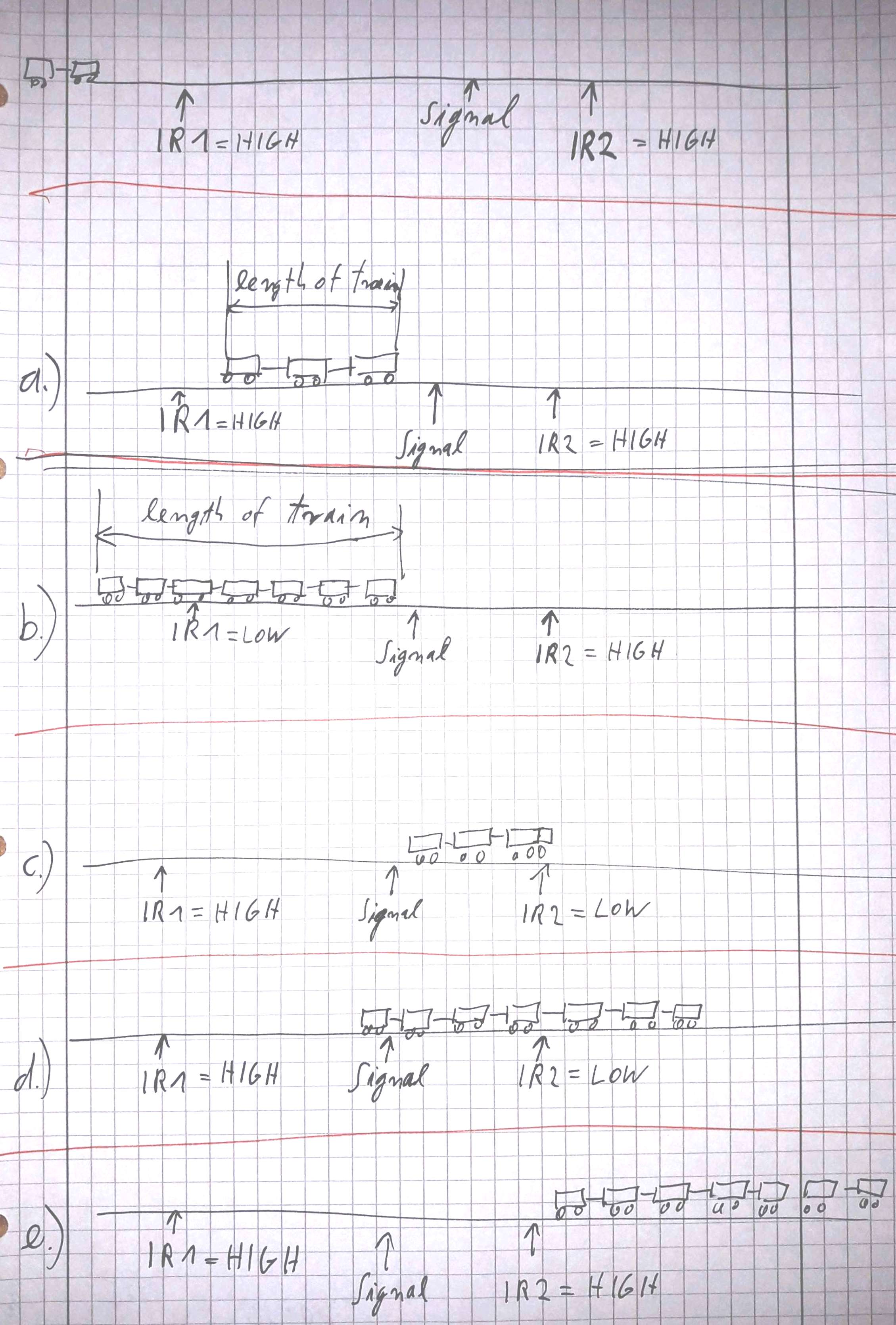

I have made a rough drawing that shows my understanding of your project. Please look at this drawing if my understanding is correct. If not make a similar drawing that shows how it really is. This drawing shall give you an example of how things can be cleared up by a "quick and dirty" hand-drawing. Only the principles have to be recognisable.
The basic principle is
1.) to analyse which sensor has witch state (LOW or HIGH) in which situation
2.) is there a fixed sequence of sensor-state-changes (IR1 goes from HIGH to LOW and stays LOW until ... etc. etc. etc.)
This may afford more drawings than I have done so far if there are a lot of variables like different train-lengths, etc.
Most users here would shout a "Hooray! finally a single user that posts sufficient hand drawn pictures of all states that could happen Very interesting combination of factors very intriguing challenge to write the code to solve this control-problem!"
If my understanding of the situation is 80% correct a statemachine will fulfill all your dreams how to control it. And once you have understood the basic principle of statemachines you can write code that everybody drops the jaw on the floor about what wild things go on on your modelrailway precise as a clockwork never crashing anything.
So give it a try to draw a corrected picture. And give it a try to understand how statemachines work.
If your situation is clear to us other users we will support you to get it going.

Hi, Your drawing is correct and everything at the moment works like that ... i.e this sketch works fine ... BUT ... the issue is when you look at your drawing C ) when train hits IR2 it changes Signal and Point Servos and because the rest of the train is still crossing the points they will change in my sketch and will de-Rail the train ... and I want them to NOT change till all of train passes IR2 ... So goes HIGH ... so if I can get IR2 to do 2 operations that would be great ..
IR2 sensor operation
1st Operation just to change the signal back to RED.. High to Low when train hits it
2nd Operation change point servo's when ... Low to High when last carraige passes

    case EXITING_BLOCK:

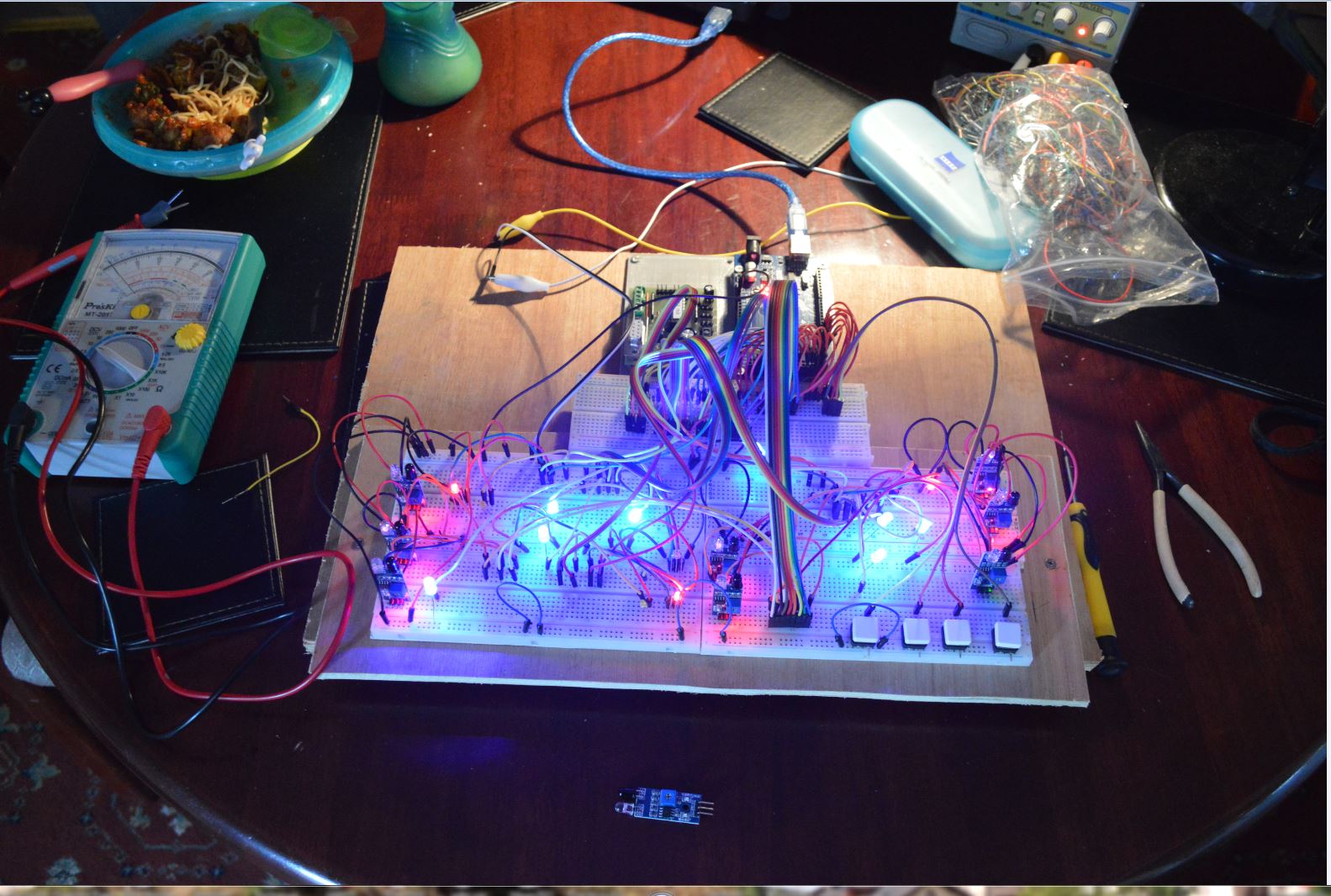

Thank you all for suggestions ...not sure were everyone lives but im in UK and its 19.30 know so another go tomorrow ...
And I will try your sketch with another Uno I have ...
Thank you I am most grateful for help..
John
Thanks again for help most grateful...
This is my breadboard build... the Red LED's are the signals and the Blue LEDs simulate the points and the position of everything is roughly track layout .. the Yellow LED's (you can only see one middle front) are telling me train hit IR sensor..
