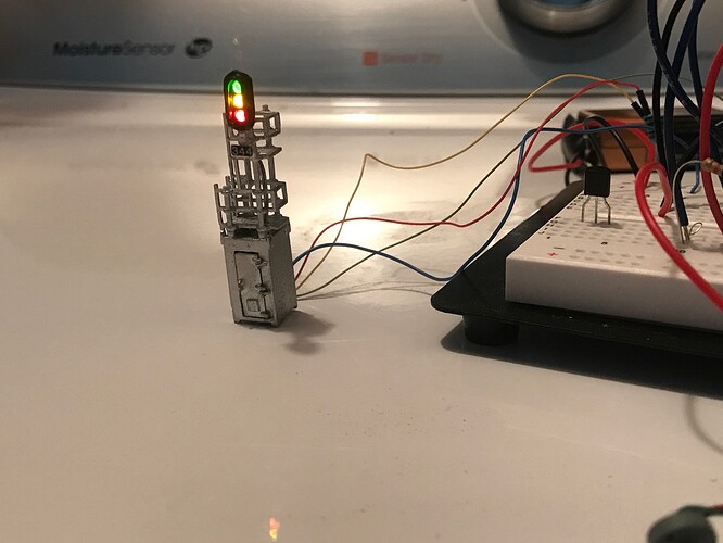

OK so I have tried so many things and gotten myself so confused I have erased all the junk out of my original code and need to start fresh with some help.
I am trying to make a block signal using IR detectors.
I have the IR detectors working and a simple IF/ELSE statement making the light stay on green, when a train breaks it, it goes to red, then when the train leaves it, it goes back to green.
I'm trying to make it so once the train leaves the sensor, it turn RED OFF, then turns YELLOW ON for 5 seconds, then back to GREEN ON waiting on the next train.
I feel like this should be really simple but every time I come across a new method it seems to get in the way or undo a previous step.

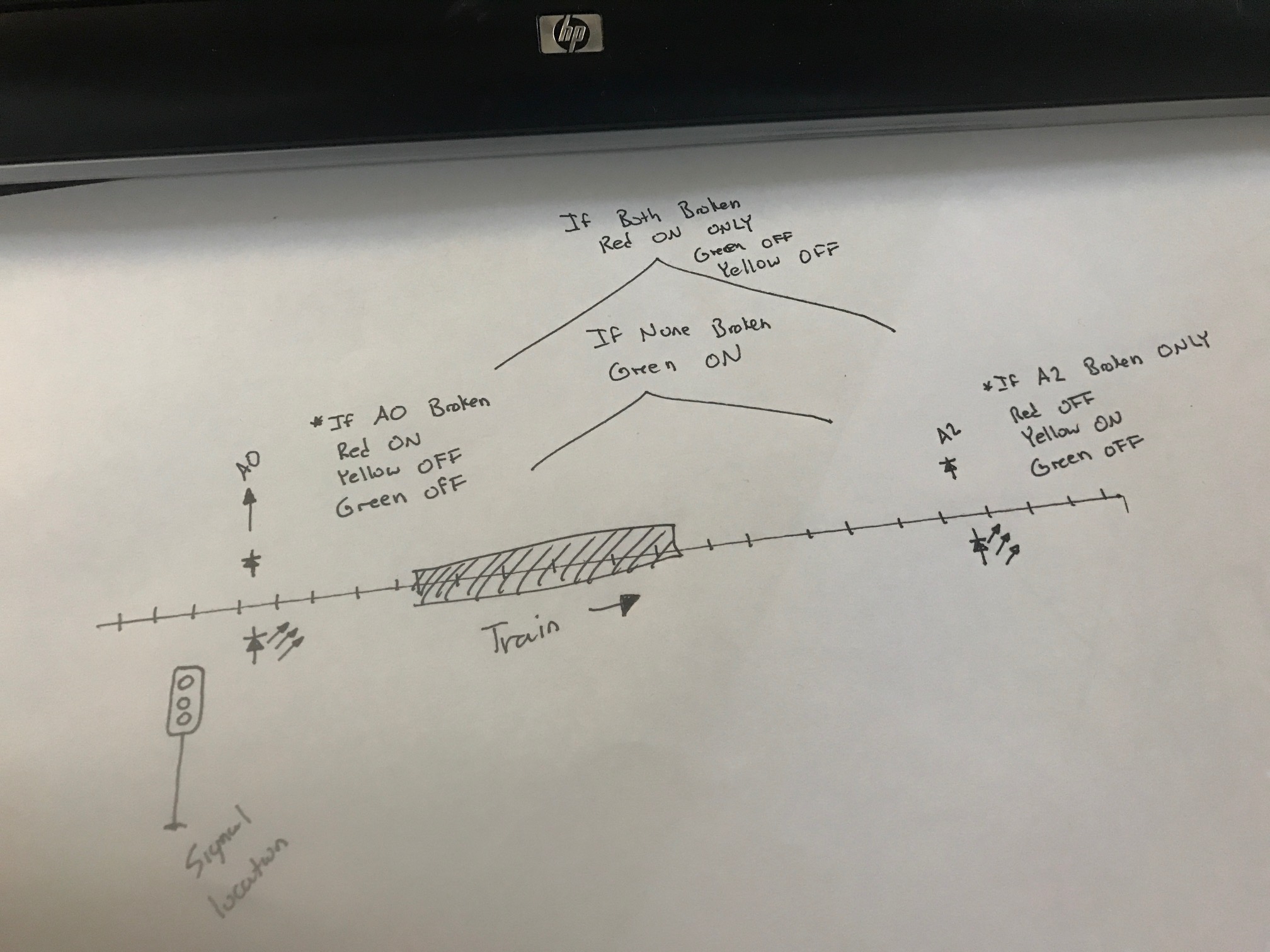

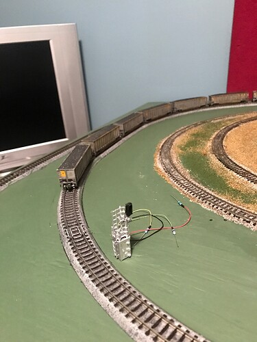

See the attached Pics. So I'm not very worried about 2 direction. When the lead engine passes the 1st sensor (A0) if drops to red from green. that block is now occupied and no other train is allowed in it. when it trips the 2nd sensor (A2) it remains red. When the tail car clears 1st signal (A0). display a yellow only. When the train clears the 2nd sensor (A2). back to green. That block is now clear.

I don't see why you need to check for BOTH detectors being triggered. Sorry, I had not realized that the second detector was to identify when the train had exited the block.
And your code in Reply #3 has not taken account of the advice in Reply #1. If you follow that advice I suspect everything else will drop neatly into place.
...R
So it looks like you need a state machine that takes three states: EnteringBlock, LeavingBlock and BlockEmpty.
Start with state = BlockEmpty
The only thing that can happen in this state is if A0 is broken, state =Entering block;
The only interesting thing that happens when in Entering Block state is when A2 is broken and we can transition to state=Leaving Block.
When in state LeavingBlock, we are looking for A2 to be clear again and we can set state to BlockEmpty again.
A switch statement will help hook this up and you'll need a state variable to check in that switch. The state tells you which light should be on.
One problem may be the gap between rolling stock - does the beam stay broken for the length of the train?

I corrected an error I had in Reply #7. However I think I was still partly correct. A short train will not be able to trigger the detectors at both ends of a block at the same time so the logic should not rely on that.
I think @wildbill has it right in Reply #8
