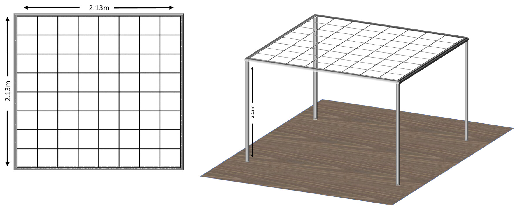

The area of interactivity will be a 7'x7'x7' (2.13x2.13x2.13m) truss rig setup (see image)
I would like only one person at a time to use the interactive space, so the number of activated sensors could be around 15. This is just a guess but it may depend on the size of the person and if they run through it or spin, etc. (I may have to advise people to use the space slowly?)
Using Cycling74 - Max 8 software, I am hoping to map all 50 IR sensors to individual sounds, each will be quite short like a chime or a piano key length, so let us say 3 seconds each.

Let's say I wanted to go ahead with my design (shown in the above post).
Would I need a separate power supply for all the sensors?
What kind of connection/junction box would I need (if any)?
Despite the 30cm proximity of the sensor, is this project doable?
You can determine that starting with one sensor. If one doesn't work in the project environment, 50 won't.
Yes, you will need a separate 5V supply at least 2A.
You should use18 gauge wire to connecting everything. You can use wire nuts or euro strips for connections.
Yes it is dooable (if you get within 1foot)
