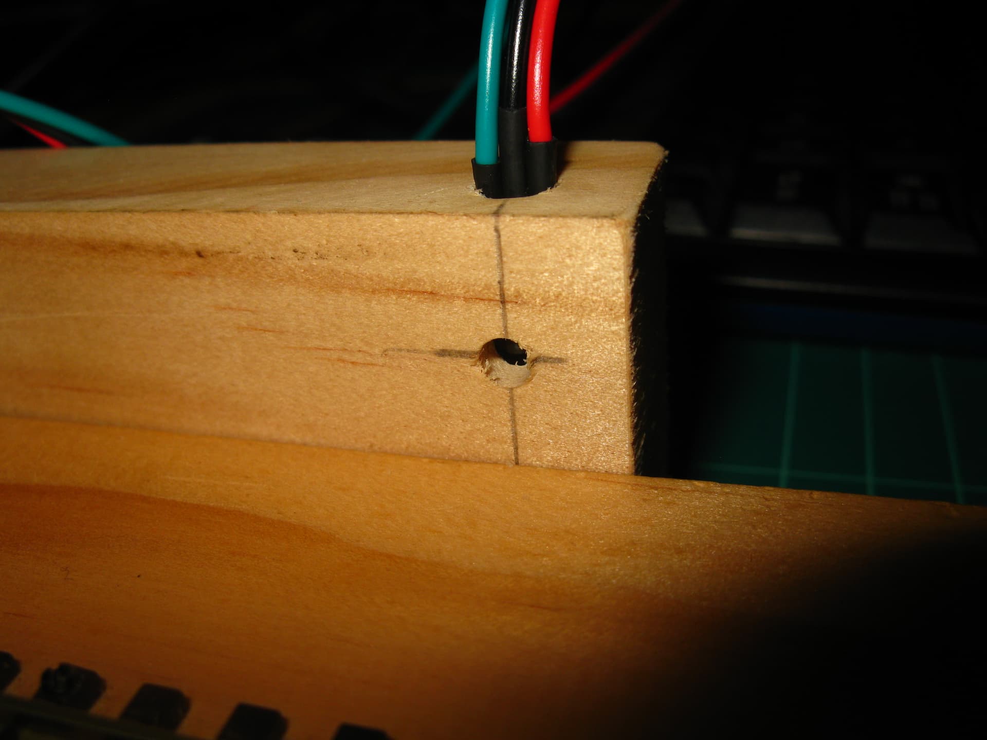

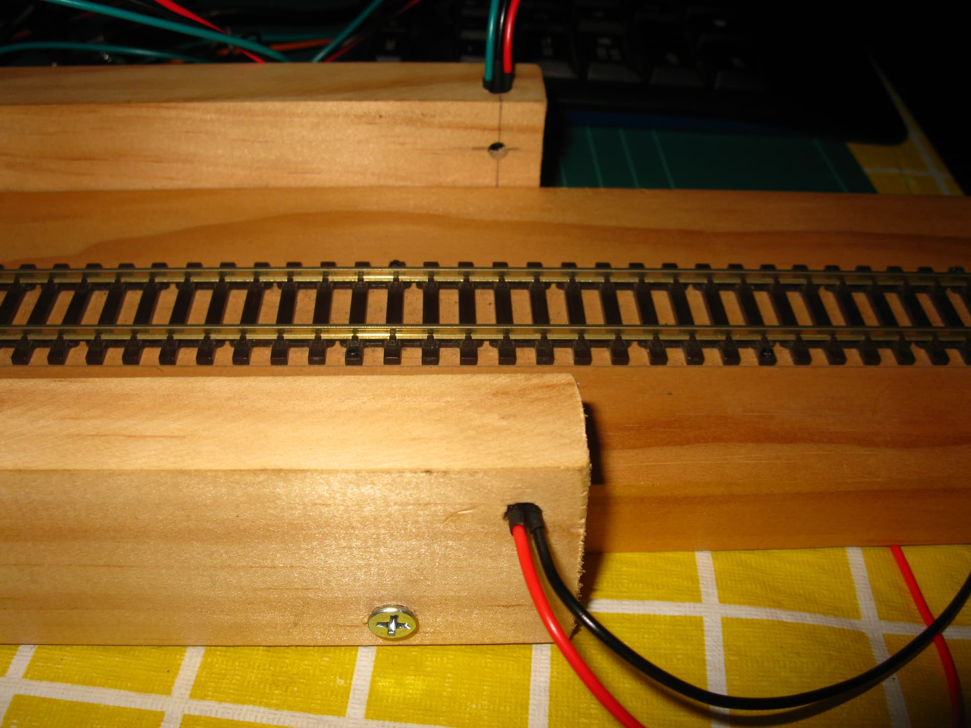

I have de-soldered the transmitter led and the three pin receiver, and re soldered them to leads. Then I have placed each part (transmitter led and receiver) on separate sides of the track. Last night, I tested the output pin of the module and it always outputs ~0.5 volts, whether the IR led is on or off. I have made sure that the led is focused directly on the receiver, but that doesn't change anything. It doesn't work. It does not detect whether a train or anything else has passed through the beam.

They are "embedded" in timber, exactly lined up, I can't really "shield" them any more than that without blocking the trains path. They are better shielded than in the original module.
Sure you can. Add paper tubes right up to where the train will hit them. OR better, yet, for a test add a tube on the sensor but allow room for you to use a piece of card board to stop the light. If that works, then you need to design a different system.
Or tunnel
