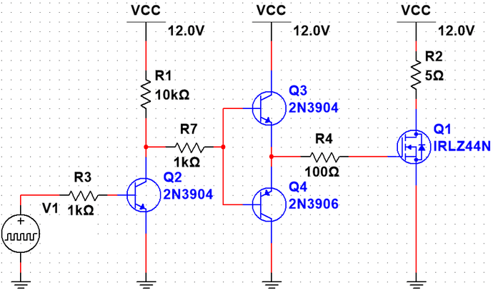

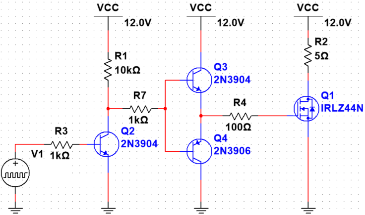

I hope you're all doing well. I'm working on a circuit to control the intensity of a load using PWM, and I'd appreciate your feedback to help me understand an issue I'm facing.
The PWM signal comes from a microcontroller at 3.3V, and I'm using a 2N3904 transistor to shift the signal up to 12V. After that, I added a push-pull stage to "clean up" or sharpen the square wave that drives the gate of an IRFZ44N MOSFET.
The circuit looks simple, but I’ve noticed the MOSFET heats up significantly during operation. Is this kind of heating normal due to switching losses? Interestingly, when I drive the MOSFET gate directly with 12V (without the push-pull stage), it seems to heat up less.
My eventual goal is to add feedback using a shunt resistor, since I already have an analog circuit that performs this type of control and I’d like to migrate it to a digital version to improve efficiency. However, if the MOSFET isn’t being driven correctly, I can’t move forward with the control loop.

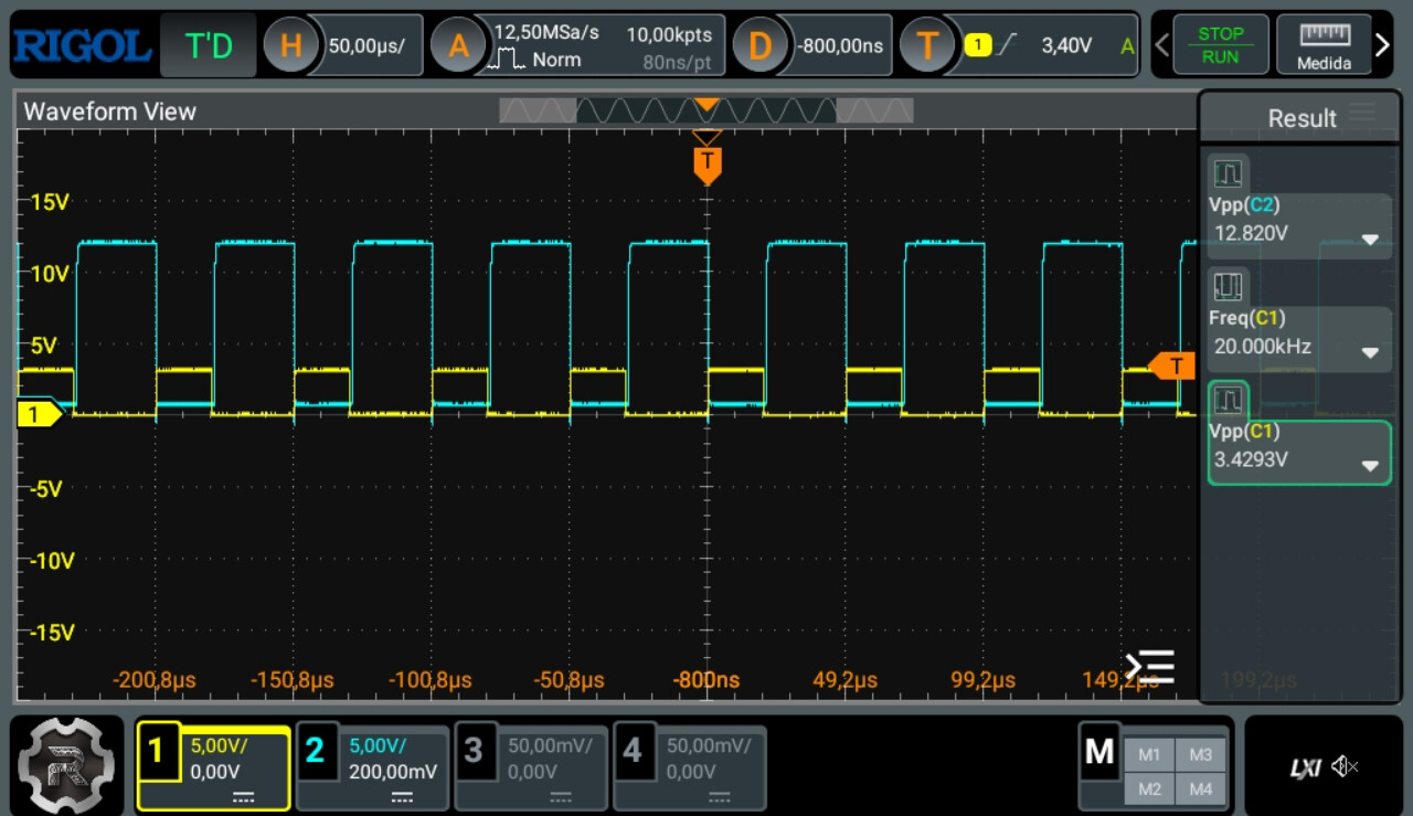

I've attached oscilloscope screenshots showing the input and output PWM signals, as well as the schematic of the circuit I'm currently using.

Sure, but since you say that the MOSFET is heating up, there is a problem. What that might be is not clear from the scope traces, as it isn't clear which points in the circuit are monitored.
I suspect that your MOSFET driver design (which is not the best) doesn't match what was actually built and tested. Look at some other driver design examples.
The schematic shows IRLZ44N. So which one are you actually using?
Is the load actually a 5 ohm resistor?
I'm using an IRFZ44N in my prototype, with a 5 ohm resistor as a simulated load for testing.
The yellow signal is the PWM output from the microcontroller, and the blue signal is the PWM signal on MOSFET gate.
I’m curious about your comment that the driver design is “not the best.” I stepped up the signal and added a push-pull stage, which I thought was a proper approach—most of the circuits I’ve seen online follow a similar structure.
Of course, I might be missing something important, so I’d really appreciate your input.
How would you improve it?

So if it is getting HOT it must be due to switching losses. However your signals look like they do have fast rise and fall times. Look at the drain signal.

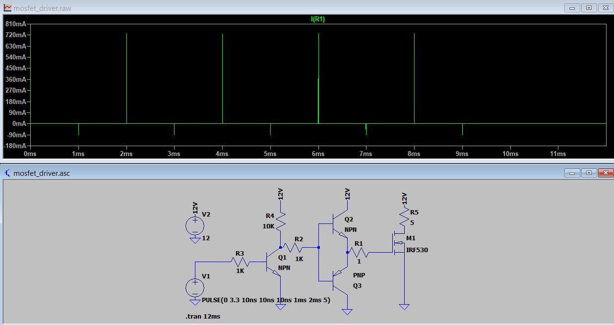

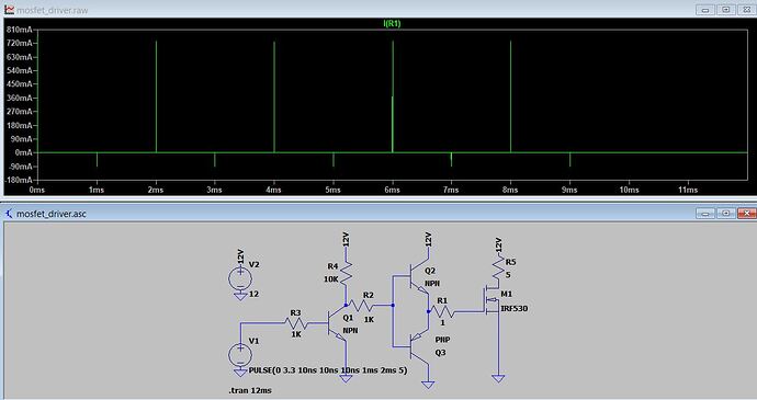

There are many problems with the posted schematic, primary among them the value of R4.
This is a quick simulation of the circuit with a much lower value of R4 (R1 in the figure below, which is not supported by the choice of small signal transistors for Q3 and Q4):
Scope trace is the gate current. Note the asymmetry.

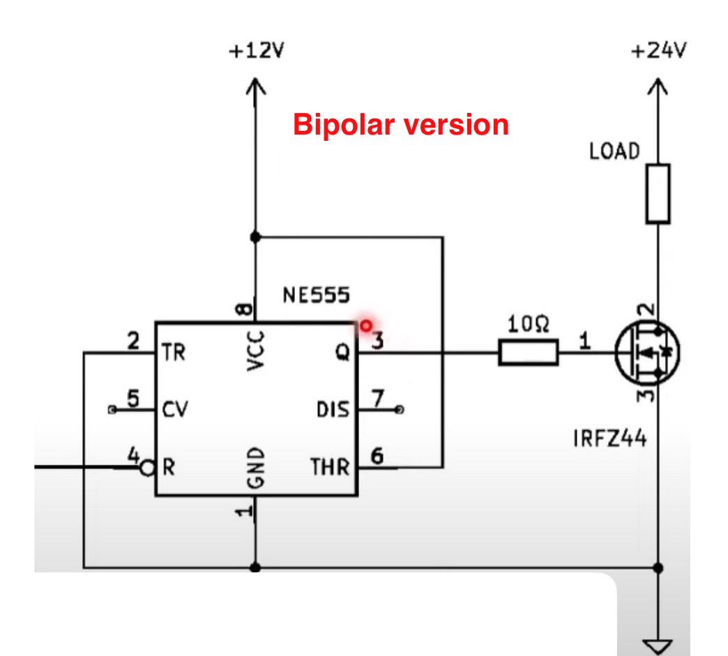

  • Try a NE555 Timer (bipolar version), 24v can be 12v.
Thanks for the simulation and explanation! I understand now that driving the gate directly or with only a 1 Ω resistor would indeed switch the MOSFET very fast—but at the cost of multi‑ampere current spikes, extreme EMI, and likely overloading my small signal transistors.

As I said, according to your scope traces they are very fast
So something else must be wrong.
What did the drain signal look like?

Your suspicion about switching losses would make sense if the gate rise and fall times were very slow but looking at the scope traces they appear to be very fast.
So it isn't heating because of switching losses, it must be IR losses.
Did you look at the drain signal

Well, I'm not generalizing, as I have been trying to point out the rise and fall times appear to be very fast so I don't think that changing the frequency (within reason) is going to have a big impact on switching losses.
Something else is wrong with the circuit or testing
I'm not sure if you're referring to the rise and fall times.
With the oscilloscope probe on the drain and no load connected, I get a fall time of 114 ns and a rise time of 285 ns.
With a load, the fall time increases to 200 ns (but it fluctuates a lot), and the rise time decreases to 25 ns.

The 25ns should not cause switching losses and even the 200n fall is less than 0.5% of the signal period, so I can't see how your MOSFET is getting hot.
When you say "hot" if you mean hot to where it will burn, then something else is wrong.
If you connect 12v to the gate with the 5 ohm load does it get "hot"?
