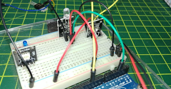

I'm pretty sure I've wired it up correctly. Ignore the LED on the right. It's not wired in.
Google Photos
The picture isn't showing up in the preview. I hope you can see it.

Since that picture didn't work earlier, I'll do it this was.
GND to -
5V to center pin
Arduino pin 3 to S
None of the tutorials said that pin 3 needed to be declared as it was done in the library. None of the examples show a pinout. Is that correct? Is there anything else I need to do or should I just glue it to a target and take it out back with a few rifles? :stuck_out_tongue:
The pins depend on the controller and timer used. You'll have to lookup the sending pin in the library, or print out the value of SEND_PIN in setup().
