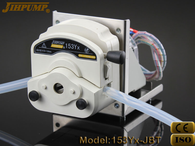

The project I'm trying to figure out involves having a conveyor belt mounted to load cells to measure the weight of the product moving along it, an adjustable rotary dial with a display and a small pump powered by a stepper motor. This pump would apply a liquid to the product on the conveyor belt and would sometimes be for example 150ml/100kg or it might be 400ml/100kg depending on the job.

This link is for the pump I'm using.

Absolutely. Using commercial grade equipment would be a must. The load cells and the pump I'm using are what I would really prefer to use as I have experience with them but everything else is up for debate. I have a very competent electrician that can wire everything up and do the fitout but he doesn't have a lot of experience with coding etc.

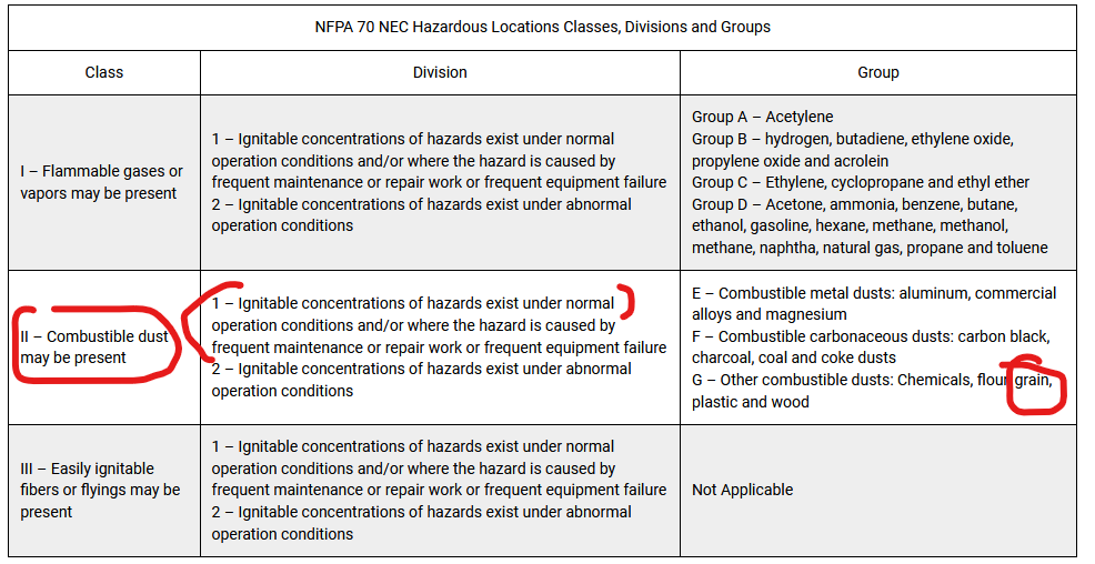

Equipment for use with grain movement is likely to need ATEX certification to be legal ( or whatever your locality demands), due to the danger from dust clouds .
You need to check that first , as it may not be possible to build your own equipment for this and only assemble from approved parts, or via IS barriers - but you need to be competent to design with these .

That is very interesting! I'll definitely look in to it but I've never heard of any regulations like that here in Australia. Thanks for the tip.

@hammy linked to UK info. FWIW, in the US, the classification system is as shown below. In Class II Div 1, for example, electrical equipment must be intrinsically safe or dust-ignition proofed by dust-tight enclosures or pressurizing the enclosures. Intrinsically safe equipment will be identified as such by the manufacturer. The "IP" system identifies dust-proof-ness.
Australia no doubt has similar requirements that must be followed and, as @hammy noted, pertinent regulations may also require a "competent person" to design systems for use in classified areas.
Ahh. I understand now. I thought hammy was referring to the actual machinery rather than the electrical components. No doubt there are all sorts of regulations regarding all that side of it. Anything electrical I've had built before for this type of thing has been in high IP rated cabinets etc.

Regulations in Oz are the same as Uk and use the same standards
