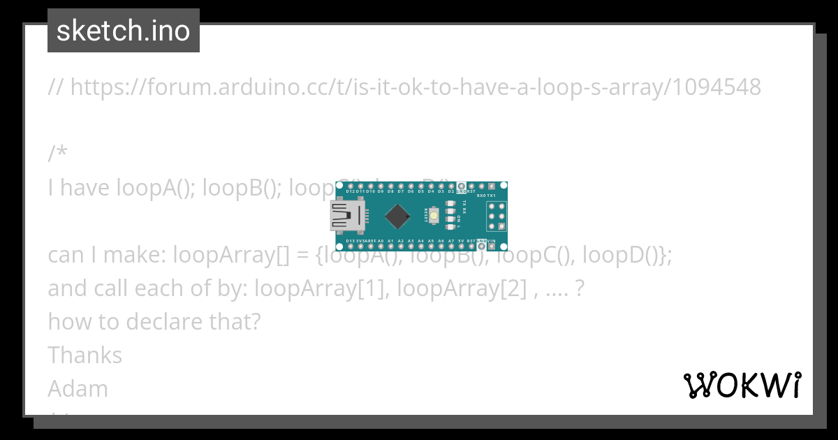

Hello shanren
Check, try and fine tune this small loop scheduler to your needs.
enum {LoopA, LoopB, LoopC};
int (*loops[])() {loopA,loopB,loopC};
/// loops ------
int loopA(void)
Serial.println(__func__);
return LoopB;
int loopB(void)
return LoopC;
int loopC(void)
return LoopA;
void setup(void)
void loop(void)
static int call=LoopA;
call = loops[call]();
