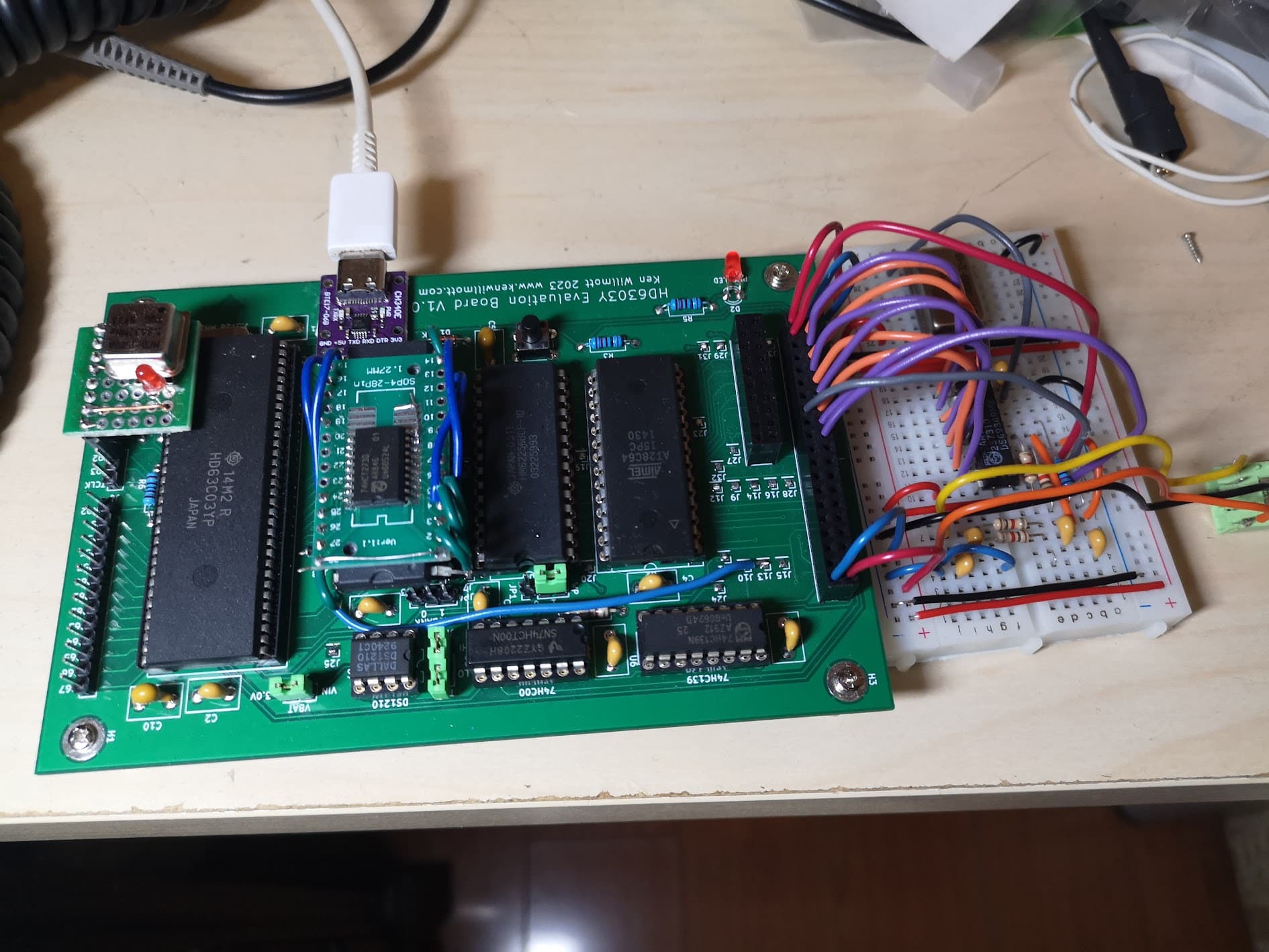

I made some changes that can be applied to a revised board, once I complete the game peripheral board. I piggybacked an address latch IC on top of a 512k by 8 NVRAM, so it's available in 16k pages where the original 32k by 8 NVRAM is located. That provides enough NV to make a small RAM disk in software. I built a baud rate generator board, which I had the foresight to support as a plug in module, visible next to the processor. With that, a 12MHz crystal can be used to run the CPU at 3.0MHz, the maximum. E clock stretching for peripheral access is already solved, Hitachi made that easy with an automatic option for memory ready signal MR. With that enabled, memory mapped peripherals are clocked at 1.0MHz.
Seen in the photo, the baud rate module to the upper left, piggyback NVRAM in middle, and a working proto board with the Philips SAA1099 stereo audio synthesizer on the right. The game board will consist of a TMS9918A video processor, SAA1099 audio, and an additional UART via an MC6850 or HD6350 ACIA. It's possible for the SAA and ACIA to share a common clock crystal with some simple baud rate divider.

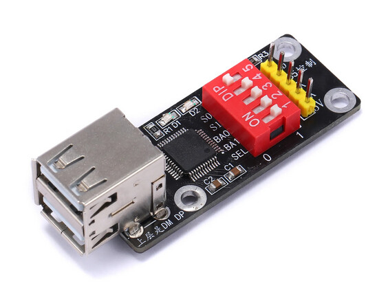

The motivation for including a UART, is to allow the unit to run completely stand alone, with text/graphic display and also keyboard/mouse with one of these:
