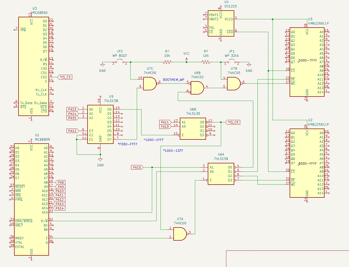

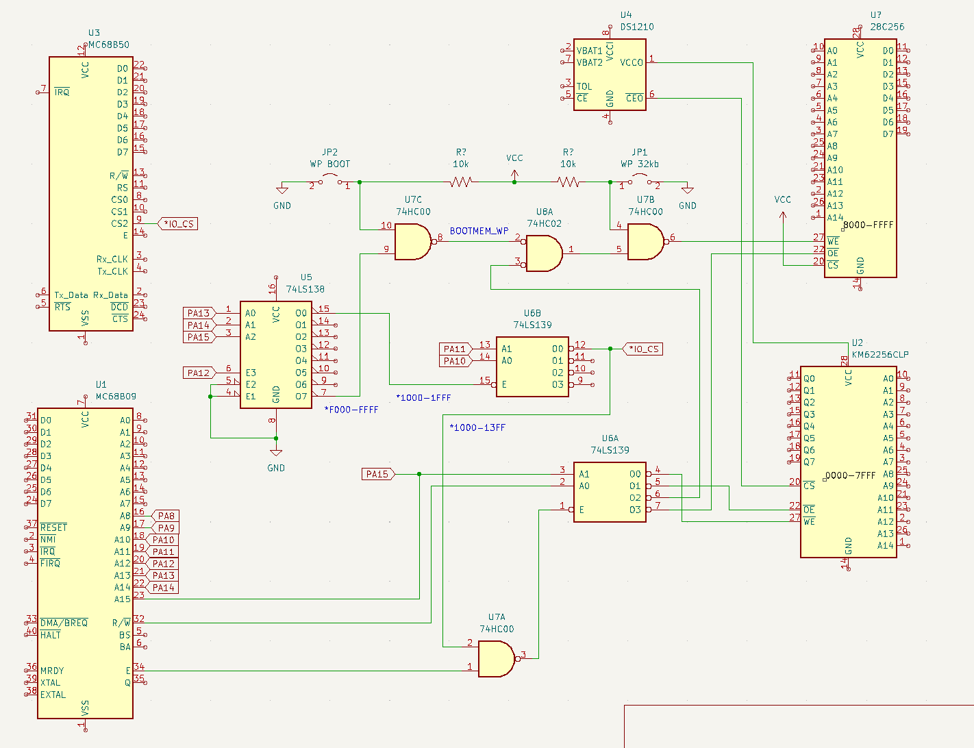

Excellent! Here is a detour I took. Instead of one 512kb RAM with paging, two 32kb RAM. I'm concentrating on address decoding and write protection. It's obviously not finished, but maybe you can see the pattern. Peripherals are mapped in 0x1000 to 0x13FF, the second lowest 1kb of memory space. By placing jumpers on the selector outputs, the I/O could be mapped almost anywhere. All 64kb memory is non-volatile. Either the upper 4kb, or the entire upper 32kb, can be write protected with a jumper. Thus 56kb of contiguous memory is available.
Good idea! A flexible memory map may come in handy.
We just got power back after three days so I've been reading a lot.:nerd_face:
Yeah, I've been downloading and reading a lot too. Of course, quickly found the Grant Searle 6 chip design, which was helpful in understanding the SRAM interface. Processor A12 goes to U5 E3 in order to enhance granularity, but it has a side effect that it can only decode odd 4kb pages. I judge that to be an acceptable trade off.

I overlooked the simplicity of writing to EEPROM. So the same circuit can replace one 32kb SRAM with one 32kb EEPROM. It retains the same write protection circuit, so that the 4kb boot section can not be programmed without removing the jumper JP2. The remainder of EEPROM can be programmed in circuit by the processor unless that too is also write protected by JP1.

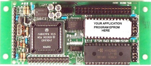

Another significant development. I unearthed a Dallas New Micros HC11 board that I own. It has Forth in ROM, which doubles as a monitor. I thought I lost both the board and the documentation, but luckily no. It's an interesting board in itself, but the key thing is that it can easily read/write JEDEC DIP pinout devices. It looks like this:
So I can do things like
OK
7FC0 40 FF FILL OK
7FC0 40 DUMP
 7FC0  FF FF FF FF FF FF FF FF FF FF FF FF FF FF FF FF
 7FD0  FF FF FF FF FF FF FF FF FF FF FF FF FF FF FF FF
 7FE0  FF FF FF FF FF FF FF FF FF FF FF FF FF FF FF FF
 7FF0  FF FF FF FF FF FF FF FF FF FF FF FF FF FF FF FF
OK
1234 7FFE ! OK
7FC0 40 DUMP
 7FF0  FF FF FF FF FF FF FF FF FF FF FF FF FF FF 12 34
OK
