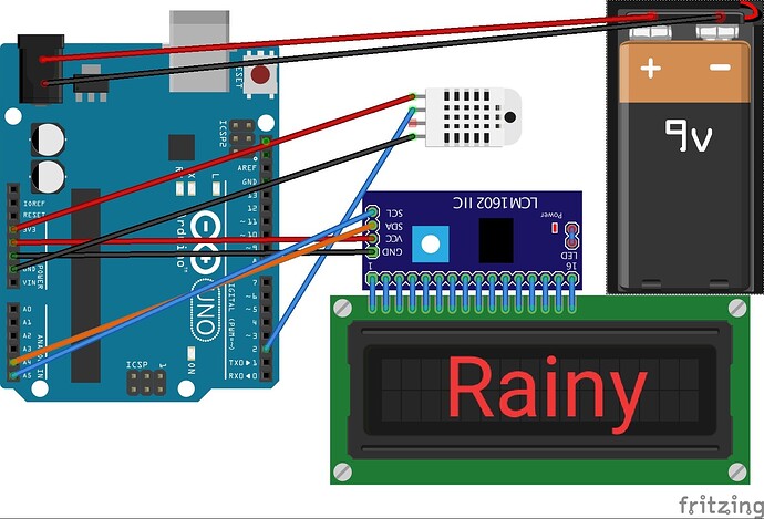

Hi guys, My group task with DHT22 sensor where we need to show in the LCD if it's raining or sunny in the outside, it is possible? or should we add more sensor?This is our expected materials. Thanks
Arduino
DHT22
LCD
Jumping Wires
Battery
Arduino
DHT22
LCD
Jumping Wires
Battery

The DH22 sensor will allow you to measure temperature and humidity. Can you determine whether it is raining or sunny from these two measurements ?
What if it is cloudy but not raining ?
Oh I didn't know about the cloudy. My prof only said that if we can record if it's sunny or rainy using dht22 sensor
We used to use a rock on a piece of string.
Wet, raining...
Dry, no rain....
On angle, windy....
Gone, cyclone....
My brain is not absorbing this haha, It's my first time using arduino and sensor that's why I didn't know haha. This is what it looks like. If the rain sensor drops some water it will show the rainy and temp, but if it's hot it will show sunny and the temperature something like that haha
Displaying an appropriate message on the screen is the least of your problems
Suppose that the DHT11 reports that the temperature is 20 degrees C and that humidity is 50%. Is it sunny, is it raining or is it neither and how do you know ?
You could use a basic moisture probe for rain, no rain, an ldr to show if it is sunny or cloudy ( or night time)....

I agree with @UKHeliBob and @bluejets that using DHT22 may not be enough to check for rain. At the best you will be able to check for higher humidities (maybe a guess that´s raining, depending on the weather conditions were you live).
There are dedicated sensors for rain drops detection, like the one on this article:
