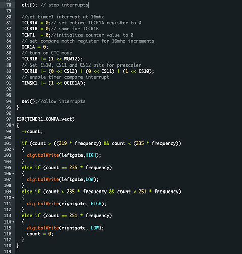

Is my ISR too long/complex?
Still getting to grips with C/Arduino, and just looking for someone to point me in the right direction.
I'm using an Arduino Micro, and I need to make short, accurately timed pulses, whilst the main program also handles SPI comms, Serial, User input via buttons/pots, and eventually bluetooth/wifi.
The pulses need to be 70 - 200us long, with a gap of 2 - 32ms, with the on time and off time adjustable but proportionate to each other. I thought it best to use Timer1 Interrupt to keep this accurate.
Here's what I've done - which works, but I feel like I'm using an ISR in a stupid way, as this will need a few for loops adding to make the on/off times modulate in a set pattern, and thats just 1 of 2 channels, and 1 of 20 "Patterns" I want to be able to choose between.
I tried making the ISR just "++count", where count is a volatile int, then make a function using the value of count to do the work, but it just can't act fast enough to keep up with the rate count is changing.
First time posting so not sure on etiquette for posting code, is screenshot OK or should I attach a text file or something to make it easier for people?

Ahh I see, cheers here goes:
(Bear in mind the hz values in comments are not correct, its 16MHz)

Your code is broken so no info on data types, but..
Here is something to consider, though; The MCU is 8 bit and performing mathematical instructions on 16 bit values requires at least two instruction-cycles. Your ISR has some multiplications which are performed multiple times (if they are not optimized by the compiler), and you could get about this like this:
++count;
  int threshold1 = 235 * frequency;
  int threshold2 = 251 * frequency;
  if (count > (219 * frequency) && count < threshold1)
    digitalWrite(leftgate, HIGH);
  else if (count == threshold1)
    digitalWrite(leftgate, LOW);
  else if (count > threshold1 && count < threshold2)
    digitalWrite(rightgate, HIGH);
  else if (count == threshold2)
    digitalWrite(rightgate, LOW);
    count = 0;
The thresholds could ideally be calculated in loop() to get them out of the ISR. If "frequency" does not change, they could be constants.
On the other hand; Why fix it if it ain't broke!? :wink:
Please post a complete program that actually compiles. Seeing variable types and other info is important.

Ahh I see, well I guess running at that speed, cutting out repetition of tasks does make quite a difference though, cheers!
Danois90:
++count;
    count = 0;
On the other hand; Why fix it if it ain't broke!? ;-)
Writing ISR's is a question of reducing the used clock cycles to an absolute minimum, so repetitive computations should be avoided/eliminated.
Or you can do the scaling incrementally and eliminate all the multiplication:
ISR(TIMER1_COMPA_vect)
  static int timerCount;
  ++timerCount;
  if (timerCount > frequency)
    timerCount = 0;
    count++;
    if (count == 219)
    else if (count == 235)
    else if (count >= (251)  //gt or eq for safety
      count = 0;
(and eliminate the repetitive write of the same value to the output port)
Ok got it, I can see what I need to do now, thanks guys!
