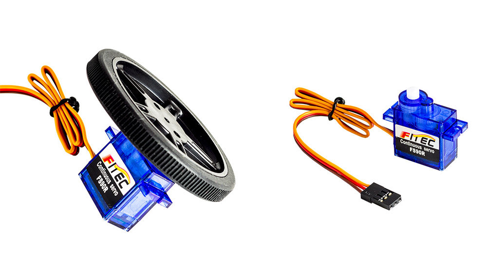

Sparkfun acknowledges multiple uses of "servo":
https://www.sparkfun.com/servos

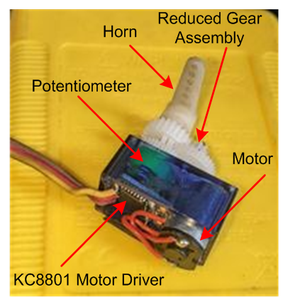

I have dismantled a newly purchased SG90 Servo (Fig-1) which contains two 8-pin SA8301 type Motor Driver chips. I am searching for English version data sheets of this chip as well schematic of the SG90 Servo System og Fig-1.
Figure-1:
Still doesn't look a stepper motor.
This is a Servo System of which the tiny DC Motor is a component. The yellow part is the 3-terminal potentionmeter which gets coupled with the Motor shaft via reduction gears.

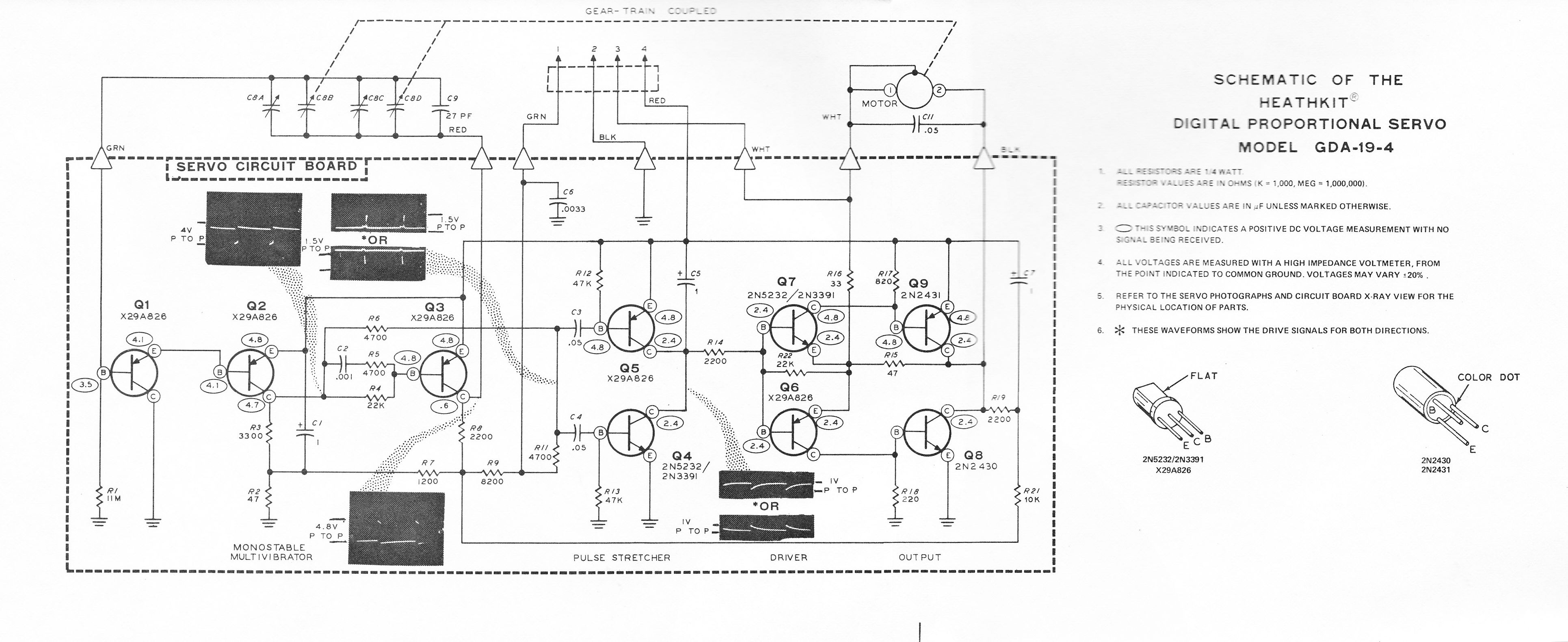

Ask and ye shall receive.
Not even a chip to decipher. I remember reading a technical article in a model airplane magazine that described a “pulse stretcher” circuit that took the difference between the pulse signal from the receiver and the pulse generated by the feedback pot of the servo to drive the motor in the proper direction. It was way over my high school age and knowledge to fully understand.
I just noticed that that schematic uses adjustable capacitors for feedback. Really different.

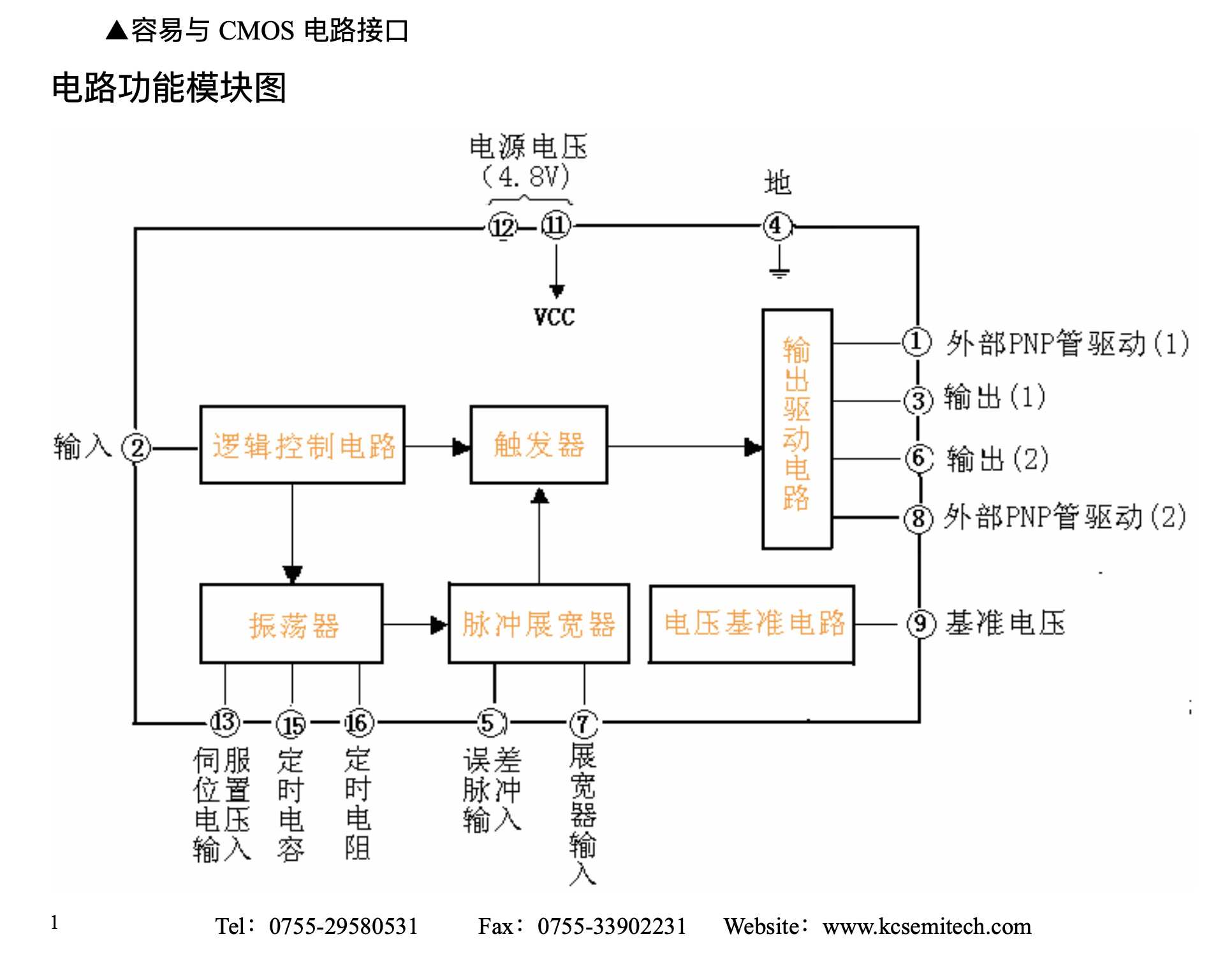

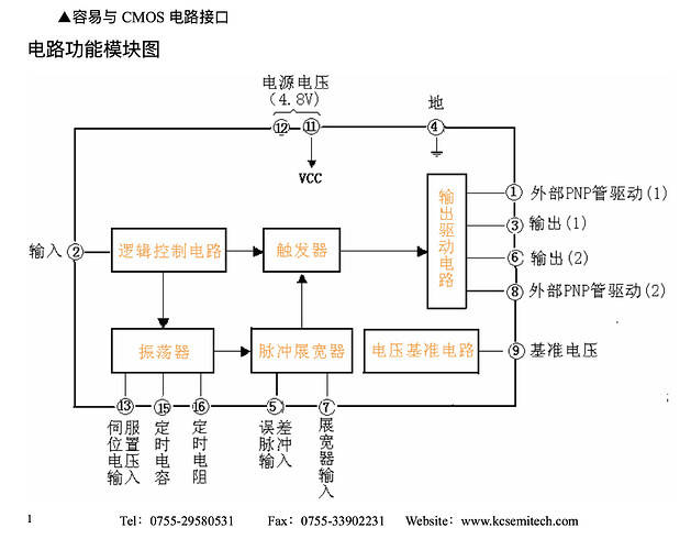

I also found the manual for the above servo. The block diagram shows the pulse stretcher.

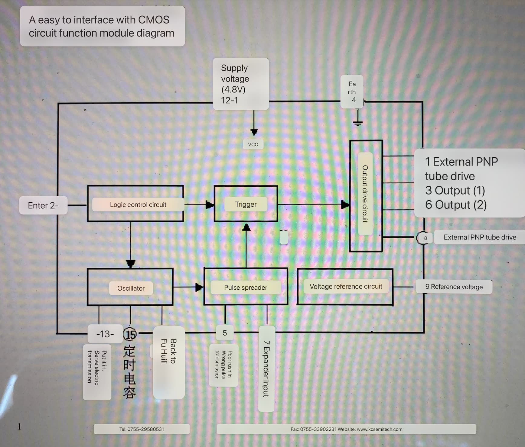

The translated 8801 block diagram from the datasheet in #20 looks like it might be similar:
The text of the document I relied on AI to read for me mentions using a constant current source to feed into one of the capacitors to make a triangle wave for the generated pulses. Maybe with a constant current source, they can use a potentiometer an constant capacitance instead of a pair of variable capacitors?
In any case, it looks like the non-digital servos use analog circuits to generate a feedback signal to balance transistors driving opposite sides of the DC motor. The input control signal drives one leg, and the generated feedback signal drives the other.

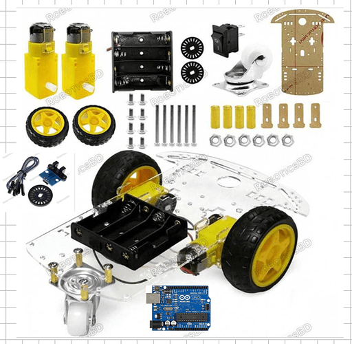

That's what I do with my pupil using the following components of a 3-wheel Hobby Robot Car to understnad the principles of Servo System.

I have performed some measurements on the disasembled SG90, and I have gathered the following data. The Servo has used KC8801 Motor Driver (Fig-1).
SG90ServoDismantled
Figure-1:
Data:
Sn. Code          PWM        Motor Volt      Motor Volt     Angular
    Executed      Pulse      during Process  after Process  Position
1   s.write(180)  2.3 ms     +2.2V           ~0.00V         180 deg
2   s.write(0)    0.53 ms    -2.4V           ~0.00V         0 deg
3   s.write(60)   1.14 ms    +1.05V          ~0.00V         60 deg
4  ----------     disconnect  ---            ------         holds previous
                                                            position
The table above indicates that once the horn has reached the desired angular position, the motor driver cuts off power to the motor terminals by zeroing the width of the resultant PWM signal.
The 50 Hz control signal (input PWM from the UNO) remains active because the UNO has no feedback indicating whether the motor has reached the desired angular position. Transitioning from one angular position to another requires a certain amount of time during which the control signal must remain present. This allows the motor driver to compute the error signal, which will adjust the pulse width of the input PWM signal before applying it to the motor terminals.
