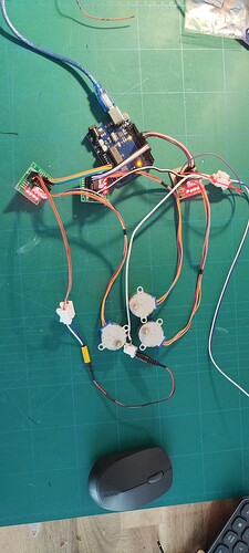

I changed the pins to 11,10,9,8 and it works now, the program generated the code, the only mistake was in the pin design.
But he didn't create it to run two motors at the same time, he created a code so that when one motor makes a turn, it stops and the other motor does the same.

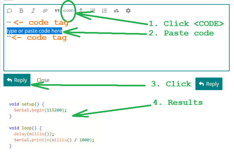

Please use code tags
Just spinning all motors at a constant speed is easy. no library needed.
I just wrote this sketch and tested it with three motors on an Uno R3.
Leo..

I have no idea what tags are.

Hello, do yourself a favour and please read How to get the best out of this forum and post accordingly (including code with code tags and necessary documentation for your ask like your exact circuit and power supply, links to components etc).
Thanks again, the code works beautifully.

  • We need to see a schematic showing all the interconnections in this project.
  • Confirm the Arduino has a common GND connection to the driver power supply GND.
What's the difference? I wrote that I didn't want to publish any details, it seemed pointless to ask in the next room something that I could ask here too... in the other section I would write it the same way as here.
I don't have the Arduino connected to the driver via GND, is it important that it is connected?
I have it wired up as written in the code.

  • There needs to be a common connection between the Arduino GND and the motor power supply GND.
    When the Arduino sends a signal from its output pins to the IN pins on the driver board, that signal has to get back the Arduino through a common GND (ground, 0v) connection.
Thank you, this is important information.
