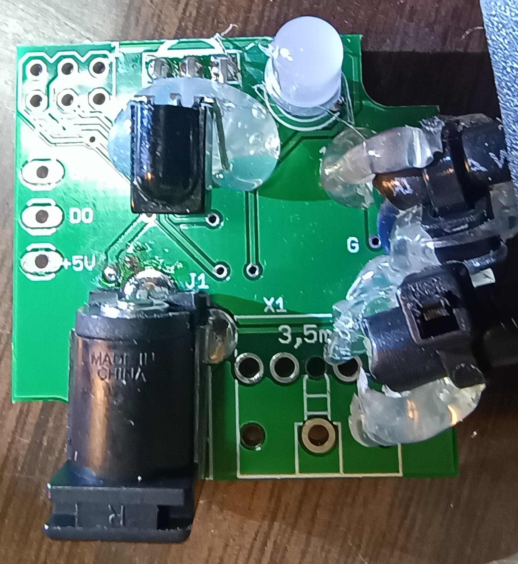

I hope I'm not putting this in too wrong a place. I have no experience with making Arduino projects. I simply have this device that no longer works and the company that made it just disappeared without a trace. It works by a piezo transducer sending a vibration which turns on an LED strip. Is it an Arduino type of device? I hoped to ask people on this forum how I might go about repairing it. I have another one and when you tap the piezo it puts out 12v. If there's no vibration there's no voltage coming out. This one has a steady voltage coming out of 5v and only slightly dims when the piezo is tapped. Thanks for any suggestions.
This is what the back looks like.

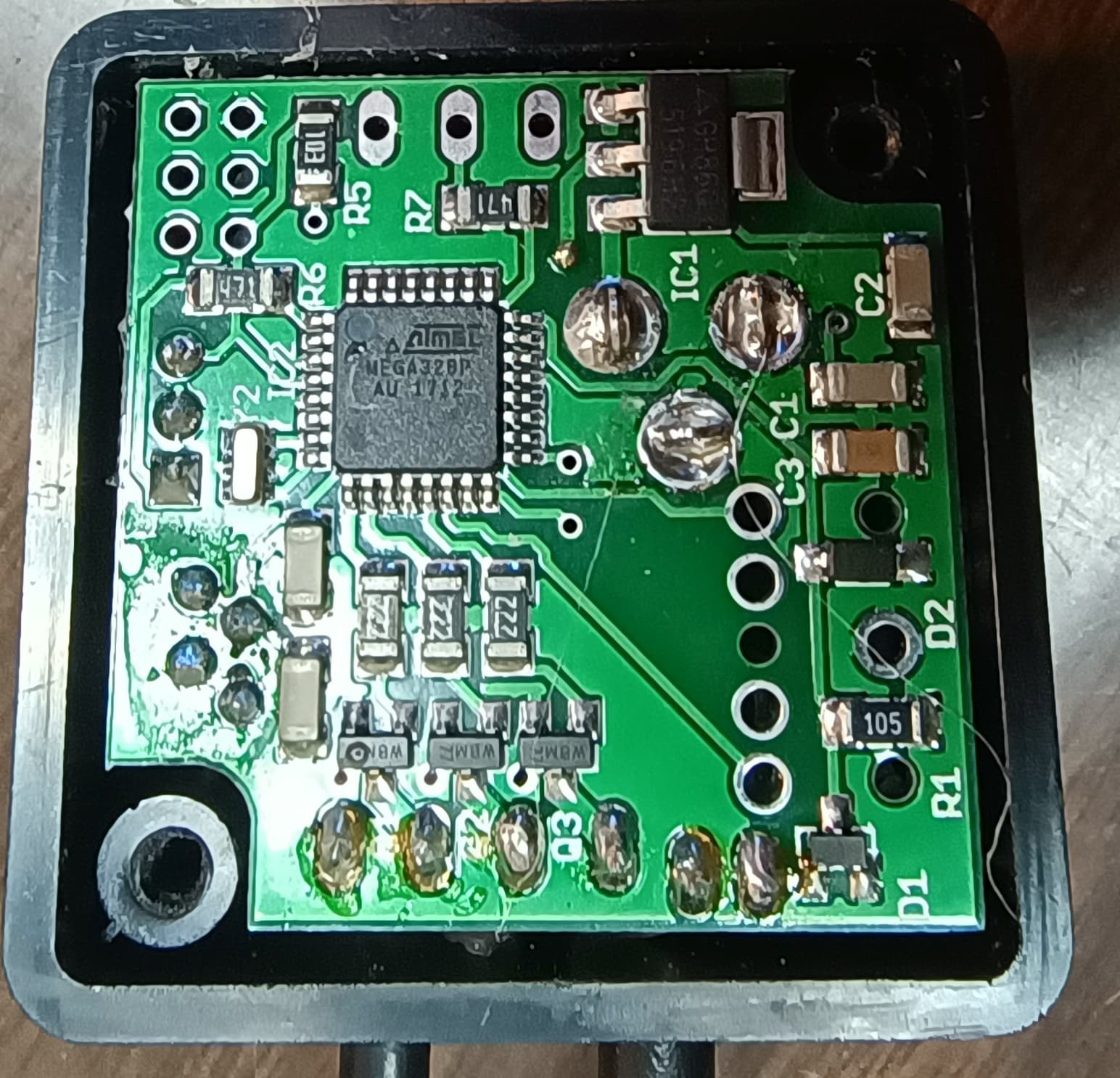

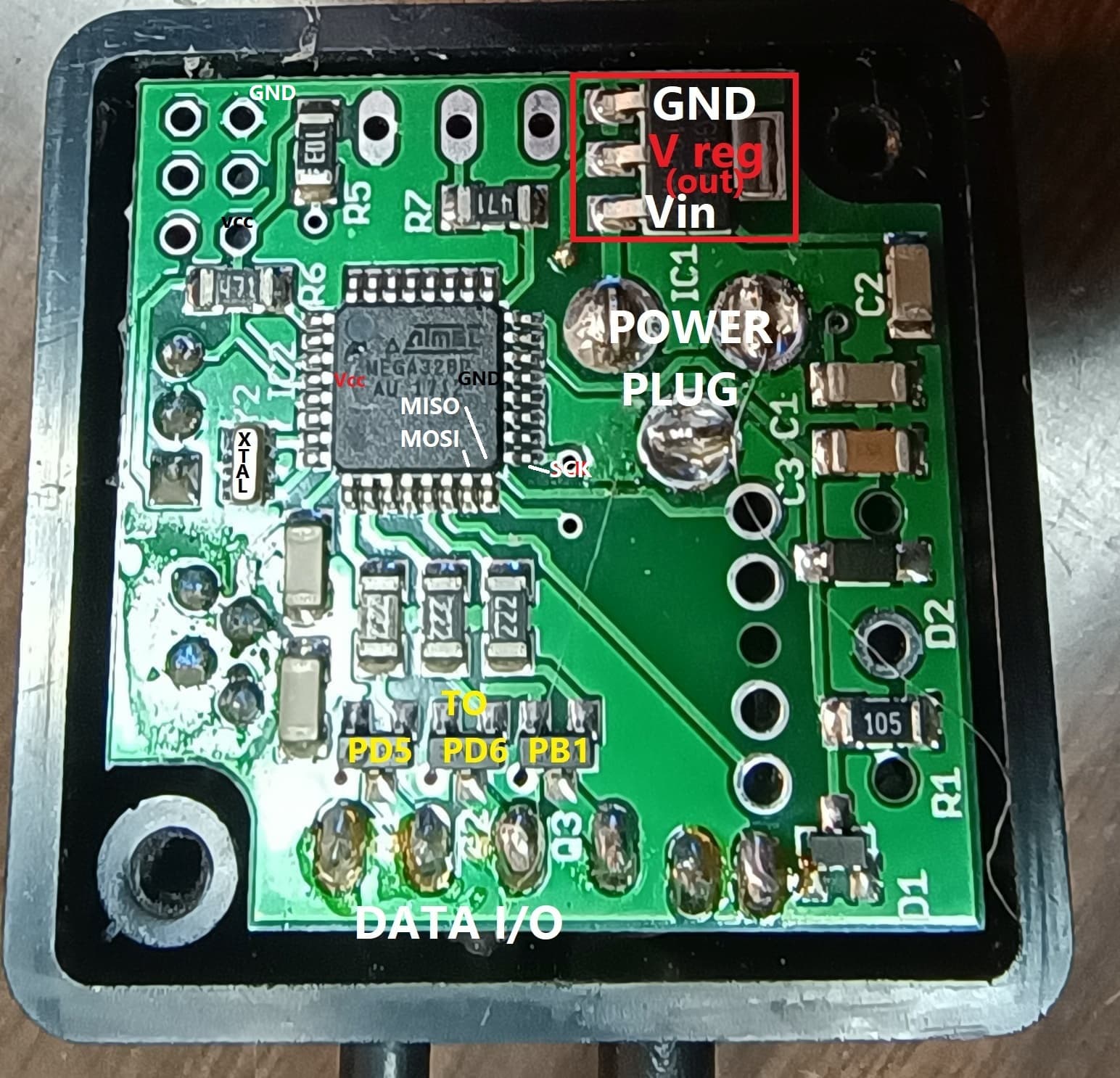

The Mega328P is Atmel/Microchp's brains of the Arduino.
Check soldering.

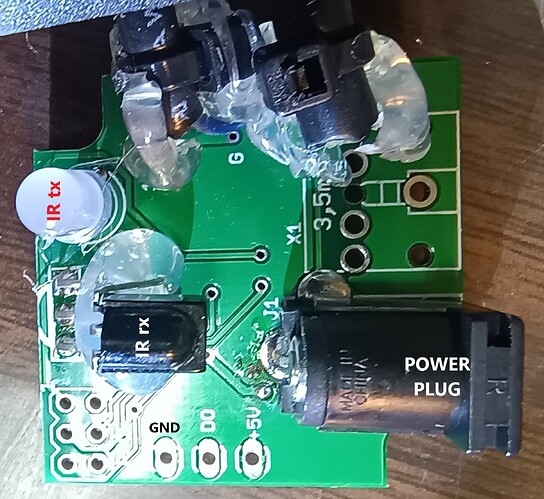

Check the IR receiver output.
Check the voltage regulator.
Check the transistors.
Swap the piezo.
Appreciate your replies. I'm afraid I'm very basic in my knowledge of circuit boards and their components but I do have a multimeter so I'll be exploring the places you said to check. I'm pretty sure it's not the piezo because I've tried a number of those. Thanks!

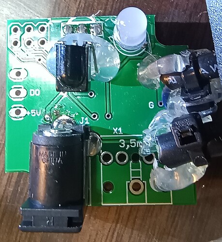

It is not an Arduino, it is looking as a custom board. But it perhaps use an arduino code inside.
I am afraid you can't do much without schematic and code, except some basic tests, proposed in the post #4.
Try to explain how the board should work - it might be easier to design and build a new one than fix it
Since you have another one that's working, you could compare resistance readings between the two, looking for any difference. That's with the power off of course. Then if you're feeling lucky, test for voltage reading differences with the power turned on.
You may be able to create a schematic from the circuit .
Wonder if that’s an icsp programner socket top left ….
