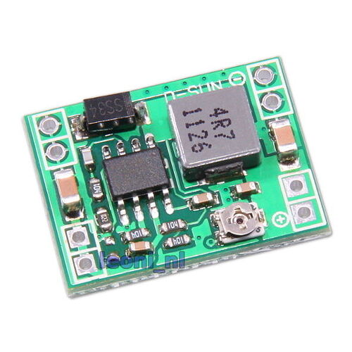

Be careful not to use arduino boards that come with bad regulators. Plenty of problems with thermal breakdown on the bad arduino regulators if you supply 12V. So check your board. If it says arduino.org, you're likely to have problems.
liudr:
Oh dear.. I've just had a MEGA 2560 delivered, and it says arduino.org
xerof:
Does it have a regulator, a small black rectangle wit metal tabs along its long sides near power barrel, that says )|| on it? It will likely not want 12V. Write a short program to print increasing numbers to an LCD in an infinite loop, say increasing once a second. Upload and watch the LCD. If it overheats and shuts down, the the number restarts. I discovered the problem about 2 years ago and the last time I heard of this issue was a couple of weeks ago. It was a 3.3V regulator on a shield.
Model is LD50 F519 - Can't see II on it.
Maybe they changed it afterall. It's still worth some tests though.
If the regulator overheats, just get one of these, they cost peanuts on eBay.
