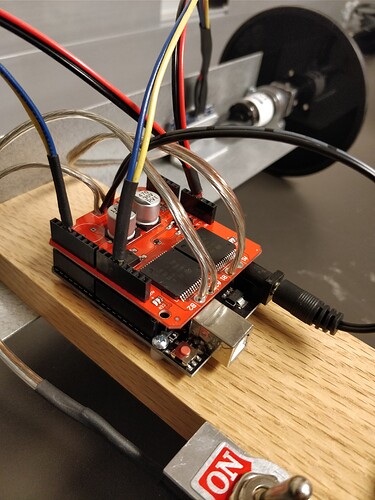

Hello everyone,
This is my first post here, so please correct me if I've messed up any part of posting to this forum.
I am having some trouble making a following robot project. I am working on this project with my professor, and I have reached a point where I am stuck. I am going to show the picture of the robot first so that you all can see the parts in their locations before I explain the issues.
The robot is supposed to use the two ultrasonic sensors to gauge distance and maintain a certain distance away from whatever it is following. The point of having 2 sensors is so that the robot can turn when the object turns.
The issue that I am having is that when one motor wants to go one direction while the other motor is either stopped or wanting to go in the other direction, neither motor will work. I think this may be an issue with my motor controlling function.
I am open to any and all suggestions, so please let me know what you think I can do. I am not all to familiar with programming, so there is likely just a simple mistake.
Here is my (somewhat silly) code.

So I edited the code a bit to include more comments about what I am doing, and I removed some redundant code. I realize that it was rather difficult to read. I also took a snapshot of the serial monitor on the output when it's doing that weird thing.
Here is the new code:

Here is the serial monitor screen:
Input 36.00 Setpoint 25.00 Direction 0 PWM 17.50
Input 37.00 Setpoint 25.00 Direction 0 PWM 0.00
Input 35.00 Setpoint 25.00 Direction 0 PWM 15.00
Input 36.00 Setpoint 25.00 Direction 0 PWM 0.00
Input 36.00 Setpoint 25.00 Direction 0 PWM 37.50

This is when the right-hand motor is too far away from the object, and the sensor can tell. However, the motor just oscillates back and forth from zero and whatever the PWM value should be. I think that it may be resetting itself every other meausrement, but I am unsure how to fix this.
Please let me know if you have any suggestions.
