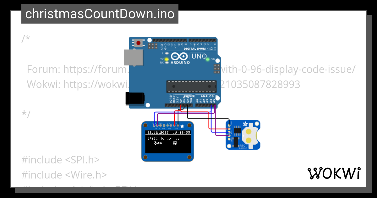

Here is a little (probably helpful) early Christmas present for you :wink:
  Forum: https://forum.arduino.cc/t/issue-with-0-96-display-code-issue/1195653
  Wokwi: https://wokwi.com/projects/383021035087828993

Feel free to check it out on Wokwi:
That's how it looks
No IR handling but the sketch uses Julian Day calculation (taken from here
DateTime calculations - #17 by jurs ) !
I have checked my calculation with libre Calc and it seems to be quite ok (one never knows :wink: ). It should even give the correct numbers after Christmas evening for the following year ...
Feel free to use it (or not)!
Good luck!
