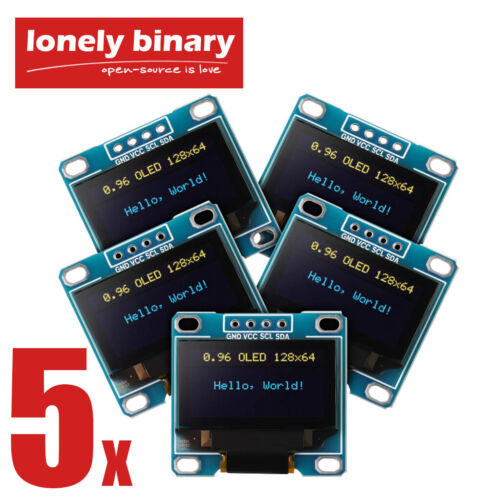

thanks David.
here is the link to the display module i bought;
The build i am trying is ssd1306_128x64_i2c from the Adafruit ssd1306 library for, i understand, a uno.
I did check the i2c address using i2c-address-finder which told me that the address for the display i have is 0x3C and i changed the following line (line 59) to that address.
59 display.begin(SSD1306_SWITCHCAPVCC, 0x3C); // initialize with the I2C addr 0x3D (for the 128x64)
// init done
Thanks for the link, example name.
Yes, most 128x64 have address 0x3C.
