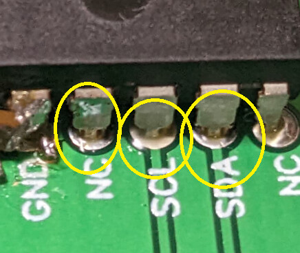

Thank you for this remark. In fact, I used hole capacitors. I will try with a surface mounting capacitor and revert.
The issue was solved by soldering a 0.1uf SMD capacitor between VCC and GND of mcp23107 (see picture). I will correct the PCB design . Thanks a million for your help.

a7
The image of your PCB shows that while it is soldered, it is not soldered very well. That is the soldered joint did not get hot enough. This might be due to the lack of power in your iron, or using lead free solder which needs to be hotter.
But the main problem might be that you are soldering pins that go straight to ground plane. This tends to suck all the heat out of your iron trying to heat up the ground plane, which by definition is quite a good heat sink.
There is a technique in laying out a PCB for getting round this, it is called "thermal relief". Search for images on this term, or / and see this link:-
It also appears the chip is not fully seated on the board.
