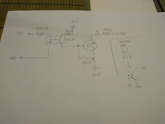

Attached you'll find a picture of my breadboard and a schematic of the circuit.
The process should be as follows:
  • Pushing the button sends a signal to the Arduino input pin (no. 4) ("Button pressed") <- working fine!
  • The Arduino then sends a "HIGH" on the output pin (no. 8 ) which goes into the PC817 optocoupler <- working fine!
  • Now here the problems start: On the other side of the optocoupler I have an external 12V source that should switch the 5V (external source) circuit of the LED via a 30N06L MOSFET.
First of all, from my understanding, the 12V circuit should not work until I push the button and send 5V to the PC817. But I can constantly measure 12 V from the collector to the emitter. Only when I push the button, voltage drops to zero. Is there anything wrong or am I not understanding the opto correctly?

The schematic is completely wrong.
You have the gate shorted to GND, plus you do not need a source resistor but you need a 10k gate resistor to GND.
The opto is drawn wrong.

I shouldn't have used this free circuit drawing program, it lacks parts and features and I drew the MOSFET part wrong - SORRY! Here's the circuit as drawn by hand:

Where the -'s of the 12V and 5V connected to? Assuming you have the +'s connected to the resistors shown.
Thank you both so much!
I removed the 330R and now the LED is permanently illuminated (yay! And as is expected because the 12V circuit is always closed, which I unfortunately still don't know how that's possible).
When I push the button now, voltage on the LED increases. I honestly expected the gate to open which would lead to the LED turning off.
The - of the 12V is floating as there is the GND of the 5V circuit that the opto is connected to. Is that wrong? Should they share a common ground? But wouldn't that defeat the purpose of the opto-MOSFET-circuit?

Point D is your 12v power supply, it should not change in either state.
What is your 12V power supply and is its negative terminal connected to H?
Is your 5V supply negative connected to H?
Check that you do have the MOSFET connected correctly.
Tom... :slight_smile:
OH MY GOD, it's working!!! :slight_smile: :slight_smile: :slight_smile:
Thank you so much, that was it! Both negative terminals of the 12V and the 5V power supply are now connected to H. I'm so stupid...
