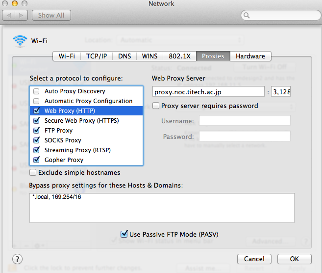

The issue is i'm trying to connect from a university where they use a proxy (without authentification).
So I tried to modify the sketch following the advices given here: http://forum.arduino.cc/index.php/topic,158690.0.html

Here are my proxy settings: ![](http://)

Sorry, here are my proxy configs :
