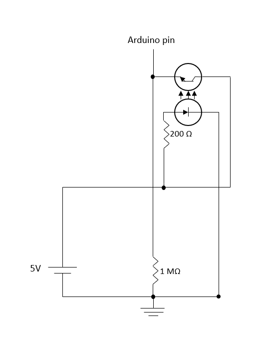

Hi, I'm building a circuit in which the speed of a spoked wheel is being measured through the use of a photointerrupter connected to an Arduino Uno pin. When the spoke of the wheel blocks the LED there is a LOW signal, and when the light shines through, a HIGH. By measuring the speed at which the signal changes from HIGH to LOW, the speed of the wheel can be measured. This works so far, but at higher speeds, the signal stays on HIGH, and if I switch to analog read, I see that the LOW voltage is higher than it should be. Does anyone have any insight as to why this might be, and how it can be fixed? I've tried different pull-down resistor values, but perhaps I'm doing something wrong.
The circuit is attached.

Have you tried a 10K pull-down?
It looks like your circuit would work but typically you'd use a pull-up resistor (with the emitter grounded).
Digital low is 1.5V or less (0.3Vcc). Digital high is 3V or more (0.6Vcc).
analogRead() is not useful for reading a photo-interrupter; use digitalRead() instead.
A lower value for the load resistor will speed up the response. 10K is typical.
Try reducing the current to the LED. Perhaps light is refracting from the edges of the interrupter. Does the interrupter have a Schmit trigger output?

It is the EE SV-3 photo-interrupter. I tried using a pull-up resistor, but it didn't seem to work properly. Would the pin still be in the same location on the circuit?
jremington:
10K did work, thanks to you and the above poster.

Please correct your circuit diagram, as the original shows a PNP phototransistor, not an NPN. The correct EE-SV3 internal diagram is as follows, and it is important to know how you have wired the phototransistor part.
jremington:
Yeah, you're right. I just didn't have a proper circuit diagram software so I wasn't paying attention. Fixed.

Which one. They come in four apertures.
10k (0.5mA) should have worked.
The transistor can sink almost 6mA with that LED current (19mA).
1Megohm is wrong.
You should write a short program to see is the sensor outputs the right digital levels.

It's EE-SV3-D.
And, yeah I did that, and the LED does seem to follow exactly. So I guess my initial problem is solved. Now I am wondering of a faster way to transfer data than serial.print. Does anyone know if serial.write is better? Or would using interrupts help in any way?
