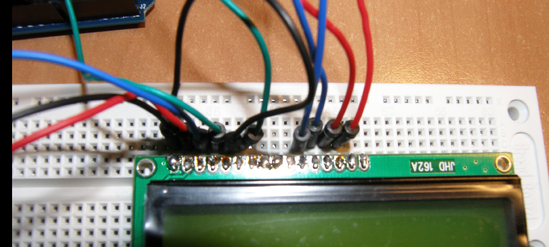

I'm struggling with 16x2 display, I know that this is a common problem, so here are the details.
Environment:
  • Arduino board and screen JHD162A are brand new from e-bay. Arduino run simple demo sketches (blinking\diming LEDs etc)
  • Arduino IDE 0021 (latest)
  • Code from demo "Hello World" of CrystalLibrary, wiring from this tutorial: http://arduino.cc/en/Tutorial/LiquidCrystal
  • LCD comes with header not soldered to it, so I soldered it myself. I not too good in soldering for now, but I've checked with multimeter that pins are not short and that the wires I use on a breadboard are not broken. I have checked +5V and GND lines from pins on the screen to pins on Arduino
  • Backlight works, I just ommited it from the photo
What I get: just blank screen, nothing on it. Contrast does nothing. One time I saw random symbols.
Photo of the wiring:
closer:
Some questions:
  • Is any simple procedure to test LCD (even without Arduino) if it is still alive?
  • Can the screen be damaged with continuity test mode on multimeter?
I've tried the alternative library described here with different wiring: http://www.skpang.co.uk/content/view/29/42/ still no luck.
I've repeated everything from scratch with LiquidCrystal library and get nothing when arduino is running the sketch. But if I disconnect screen WITHOUT resetting Arduino (while it is still powered) and put it back it begin to show random characters. When I press arduino's reset after that screen shows stripe running from left to right and again blank screen.
I also have checked all my Arduino digital pins by blinking led on them -- they all seems to work.
Can it be a problem with inialization or hardware failure?
We need to see the actual code that you used so we can compare it to the wiring in your photo. We also have to be able to unambiguously follow each wire all the way from the LCD to the Arduino.

The LCD4bit library referenced in this link does not properly initialize the LCD controller.
Most likely initialization.
I suggest that you remove all of your wires and then start again using the tutorial at Arduino Tutorial - connecting a parallel LCD. Don't skip any of the steps and if you don't get the single row of blocks (about halfway through the tutorial) then there's no sense going any further.

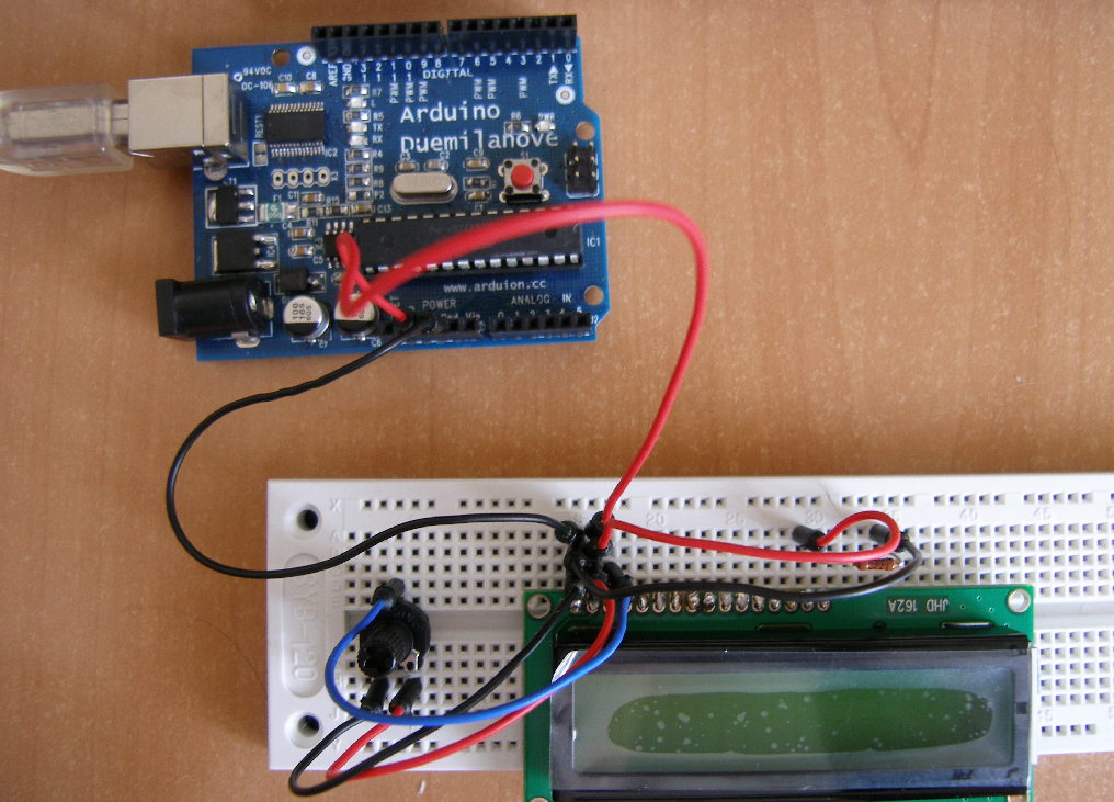

I don't see any rectangles (just blank screen with backlight on) after connecting power to logic, backlight and contrast. Here is a picture with minimal wiring:
I just add resistor for backlight (isn't this a mistake that it is ommited in the tutorial?)
Some LCD modules have the resistor on the pc board and some require an external resistor. It certainly won't hurt to have an external resistor even if there is one on the board as long as the backlight is bright enough.
Well you have to get the blocks showing before you go any further. I assume that the backlight works and that the module doesn't get hot. I also assume that you have turned the pot from one end to the other as mentioned in the tutorial.
The potentiometer could be bad. If you have another one then you should try it. Almost any pot should work for testing purposes although the recommended value is 10K. Some LCD modules work reasonably well with pin 3 connected to GND so you could try that as well.

If you are really using a 10 Ohm instead of 10K Ohm !0,000 Ohm) potentiometer then this may be the source of your problem. This alone will draw 500 mA which is the limit of the USB 5v supply. If it really is 10 Ohms then try removing the pot and grounding pin 3 and see what you get. Otherwise use your multimeter to verify that you can adjust the pin 3 voltage between 0 and 5 V.
Don
Don, sorry, this is just a small keyboard on my netbook -- pot is 10k, not 10.
Did you try measuring the voltage at pin 3?
Don
It is 0 in one exterme pot position and 3.34V in another.
I measured voltage on 5V pin of Arduino it is 3.54, why? The 3.3V pin gives 3.3V, so my multimeter seems to work...
I powered Arduino with external 12V brick and it shows rectangles on the screen!!!
I plugged 12V supply in addition to USB cord and now example works. But I don't understand why it doesn't work from USB? I've tried my notebook USB port and external powered hub -- it gives 3.5V and screen doesn't work. With external power supply it works...
I've tried my notebook USB port and external powered hub -- it gives 3.5V ....
Although the 328 can run at a lower voltage, the Arduino is configured to run it at 5 volts. The LCD module is probably also designed to run at 5 volts although there are some that run at a lower voltage.

The automatic power selection switches from the USB supply to the external supply whenever the external supply is more than approximately 7.3 Volts. Here's a diagram that I drew to figure out how it worked when the Duemilanove first came out. If you want a pdf version then copy the 'image location' and substitute pdf for gif. The UNO is somewhat different but the principle is the same.
It looks like your netbook USB port is not supplying 5 V.
Don
