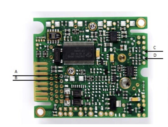

1. Sensor Output Stuck:
After I short C + D for a quick start, the sensor outputs a value around 500 ppm. However, this value doesn’t change over time, even after waiting 15 minutes for the sensor to warm up. The only way the value changes is if I short C + D again, but then it gets stuck at the new value. It does not seem to update in real-time after that.
2. Sensor Reads 0 ppm After Power Off:
When I power off the sensor and turn it back on, it starts reading 0 ppm and doesn’t recover or show any CO2 value unless I short C + D again.

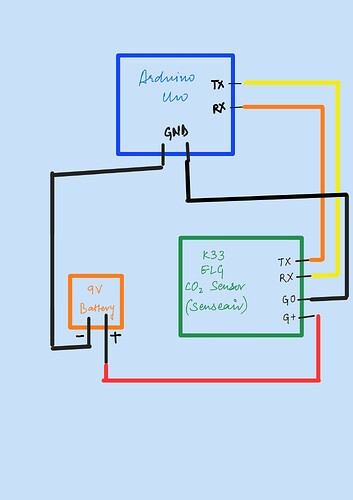

Hi, @bara12
Welcome to the forum.
Thanks for the information.
If you are using a 9V PP3 smokedetector battery, it will not be supplying enough current.
Do you have a DMM? (Digital MultiMeter)
Thanks.. Tom.... :smiley: :+1: :coffee: :australia:
What does that mean? No C nor D in the wiring.
That's fully okey as the device is not initialized (K_30_Serial.begin(9600):wink: like it is in setup().
In general, don't connect or disconnect single devices when other devices, like the controller, is powered.

Just to clarify, I'm using a single jumper wire to momentarily connect the C and D pins on the sensor, as mentioned in the datasheet for a quick start.
Noted: I won’t connect/disconnect parts while the controller is powered on. I’ll be more careful going forward.
i have referred to this PDF.

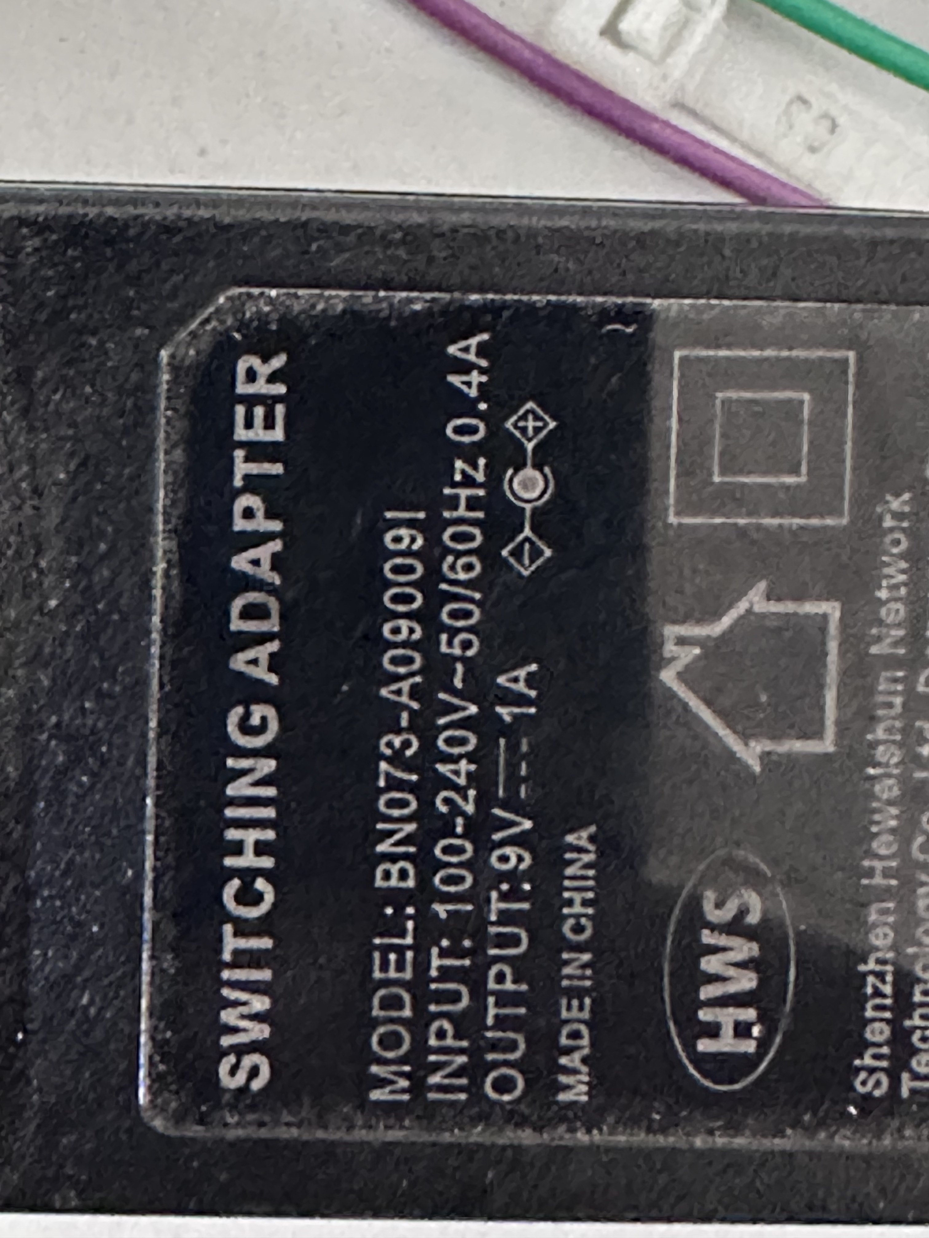

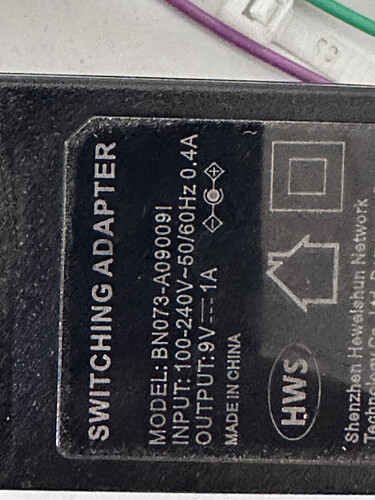

I've now replaced the 9V battery with a 9V, 1A power adapter and also switched from using an Arduino to a Raspberry Pi 5. However, I'm still getting the same repeated CO₂ value—it doesn't seem to update in real time.

Hi, @bara12
From the indestructible link;
2. Power. While the Arduino's 5V power is theoretically able to power the K-30, the sensor needs 300mA minimum to operate the light inside the sensor. The problem is, if you power the Arduino from your PC's USB port, the K-30 has to share power with the Arduino, your mouse, and any other devices on the USB bus. The power to the sensor will drop under 300mA, and it won't operate properly.
You have 2 options:
  1. Use a powered USB hub as shown in Step 3.
  2. Power the K-30 with a separate 6-9VDC, 500mA external power supply. If you don't have a wall adapter like this around, you can use a 4 doubleAA battery box
Hello Tom,
Previously, I was powering the Arduino through the USB port of my PC, while the K33 sensor was powered separately using an adapter. I'm not sure if this setup is causing the issue or where I might be going wrong.
I’m stuck.:hot_face:
Noted: to use a 4 double AA battery box.
