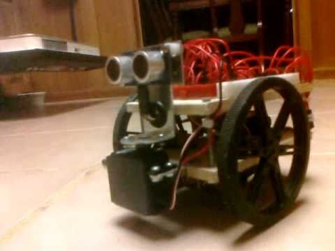

Keeva Bot Differential Wheeled Robot w/ Dual H-Bridge/DC Motors/Ping Sensor
This is the Keeva Bot Project. Keeva stands for Kinetic Electrical Evasive Vehicle Apparatus.
I have a couple of videos on youtube of the robot in operation here...
Keeva Bot was my Capstone project @ ITT-Tech.
I will still be making more upgrades, so any idea/comments are welcome.
A few tech specs:
-Arduino Uno
-Parallax Ping Ultrasonic Range Finder
-sn754410 IC
-7404 IC
-4x AA batteries (DC Motors & Servo)
-9v Battery (Arduino)
-206:1 Micro Metal Gearmotor
-Parallax Standard Servo
-Pololu 90mm Slim Wheels
Additional Upgrades (to be added):
-PWM for the DC motor using the h-bridge enable (I have tested the coding and functionality and everything works)
-Optical Encoding (I have been able to obtain the data coming from an optical mouse chip and hope to use this for left/right movement and foward/back speed)
-Photo-voltaic cells for lightchasing/line following/ edge detection
cool. what's the software like?
is the poor thing trying to get out of the cage in the second video?
I have posted the software below....
And yes Keeva is trying (poorly) to get out of the boxes. It was not originally intended for that purpose but it was interesting watching it try to get out. I could make it much better at getting out, but i was mostly concerned with it not running into things.
Sorry the code is poorly commented... :frowning:
btw this is the first thing I ever programmed with arduino, so be gently but please point out errors.
