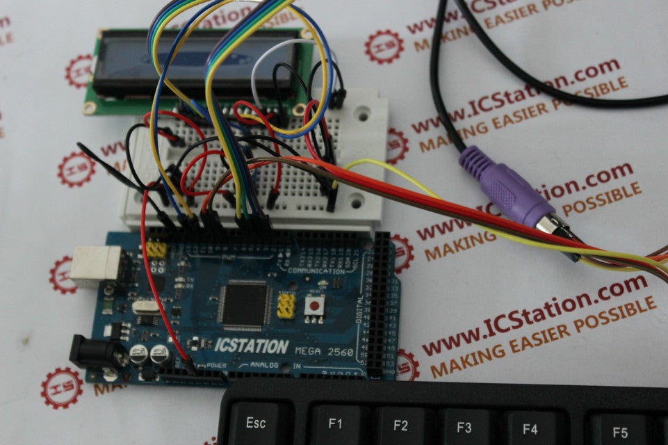

I use this connection

I changed it:
pin 9 -> pin 3
pin 8 -> pin 2
and it worked!
The problem now is that pins 2 and 3 were connected to the LCD.
So, how can I use PS/2 and LCD at the same time? Can I use PS2Keyboard.h or should I make new functions ?
The LCD pins don't need to use the external interrupt pins. Find two unused digital pins and move 2 and 3 there and changed the function call that instantiates the LCD object (often called lcd) to reflect the two new pins you selected. For example, you may have had it:
Since 9 an 8 are free, try:
LiquidCrystal lcd(12, 11, 5, 4, 9, 8);
and see if that works for you.
Thnx a lot, it worked fine!
