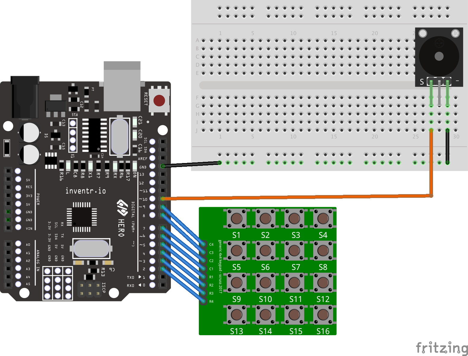

Arduino Uno. Wiring diagram attached. I am working through a tutorial on using a keypad to make musical notes with a buzzer. The first step ties keys to a specific character (1, 2, 3, ... A, B, C, etc) and then prints the character to the serial terminal. This works just fine, so I know it isn't a wiring or hardware issue.
In the next step, instead of sending characters to the serial terminal it is supposed to send an integer frequency to a buzzer to play. When I implement that code, the serial terminal shows completely wrong values being generated.

The getKey() function return a value in char type, which ranges from - 126 to 125. Any value that out of this range will be casted.
IoT_hobbyist:
Thank you! That solved it.

You can use a better way by using array.

This is a good idea, but getKey() returns 0 when no key is pressed, causing the first tone to be played.
An easy fix to this, at a cost of 2 bytes, is to index the keys from 1 to 16, and add a dummy integer at the beginning of 'tones_table'.
