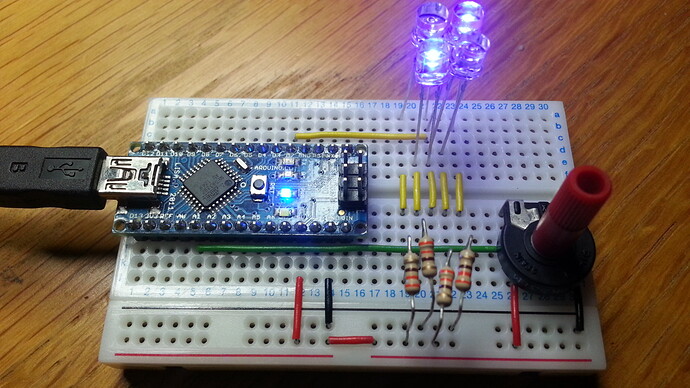

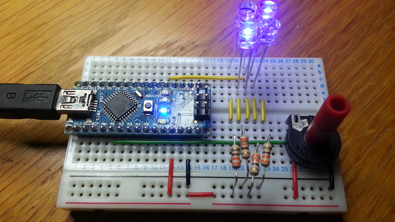

Hi Michael, here is the circuit with the 4 leds using only one Arduino pin:
And next with a pot to control the speed:

This is just the "blink" example sketch with a couple of adjustments:
  Blink
 Turns on an LED on for one second, then off for one second, repeatedly.
// Pin 13 has an LED connected on most Arduino boards.
// give it a name:
int led = 2;
// the setup routine runs once when you press reset:
  // initialize the digital pin as an output.
  pinMode(led, OUTPUT);
// the loop routine runs over and over again forever:
  int d = analogRead(A1);
  digitalWrite(led, HIGH);   // turn the LED on (HIGH is the voltage level)
  delay(d);               // wait for a second
  digitalWrite(led, LOW);    // turn the LED off by making the voltage LOW
