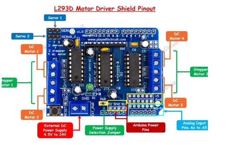

I'm facing a very specific and frustrating issue trying to get a standard L293D Motor Shield (an Adafruit V1 clone) to work with a Keyestudio ESP32 PLUS board. I'm hoping someone in the community has encountered this and can offer a solution.
Goal
My goal is to reliably control all four DC motor channels (M1, M2, M3, M4) on the L293D Motor Shield using a Keyestudio ESP32 PLUS board, which has an Arduino Uno R3 layout.
Problem Statement
When I run a test script to sequence through all four motors, only motors M1 and M2 work correctly. Motors M3 and M4 do not run at all.
The most critical piece of information is this: The exact same shield, with the exact same motors and power supply, works perfectly when placed on an Arduino Uno board. This confirms that the shield, the L293D ICs, and the motors are all fully functional. The problem only occurs when using the ESP32.

The Core Question for the Community
Given that the shield works perfectly with a 5V Arduino Uno but fails on the 3.3V ESP32 (specifically on the M3/M4 channels controlled by the 74HC595 shift register), has anyone else experienced this?
Is this a known 3.3V vs. 5V logic level incompatibility with this specific shield's shift register? And if so, has anyone found a solution that does not require an external logic level shifter?

The Adafruit board uses a 74HCT595 not a 74HC595 The HCT version will work with 3.3V I/O
Replace the HC with an HCT

When I swapped the motor bit mapping as you suggested, none of the motors were running. However, after changing the mapping as shown below, all motors started running, but in the order M1, M2, M4, and then M3:
const uint8_t MOTOR_BITS[4][2] = {
  {2, 3}, // Motor 1
  {1, 4}, // Motor 2
  {0, 6}, // Motor 4
  {5, 7}  // Motor 3
  //{0, 6}  // Motor 4 (previous position)
I realized the issue was due to a mismatch in the PWM enable pins. After swapping them as shown below, the motors started running in the correct order:
const int M3_PWM_PIN = 27; // Shield pin D5 -> ESP32 GPIO 16
const int M4_PWM_PIN = 16; // Shield pin D6 -> ESP32 GPIO 27
  {2, 3}, // Motor 1
  {1, 4}, // Motor 2
  {5, 7}, // Motor 3
  {0, 6}  // Motor 4
Thank you
