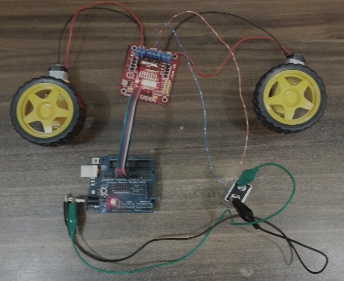

Can any body help me with my l298n motor driver board
I have tried alot of things but the motors won't run. The LED of the board is turning on .
Can you provide a circuit diagram, containing all used components, including the motor power source? Your power source must match the motor requirements (voltage and current), an Arduino can not normally power a motor.

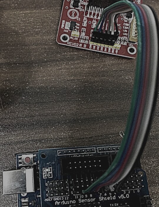

I attached a photo shows how I connected every thing.
And that's the code that I am running

I connected the Arduino and the l298 to 9v battery
Such batteries are not very useful with motors, get some more powerful supply. What is the measured battery voltage, when you try to run your motors?
I also suspect that you failed to connect the power to the motor driver properly. The module needs 5V for the logic, which can be obtained from the Arduino, and an additional motor supply voltage. Please try to make a circuit diagram, photos are not very helpful in finding wiring mistakes.
The L298 drops at least 2V so the best you'll get at the motor is 7V. But when the motors ask for significant current like they will do at startup, that drop can be about 5V if my memory serves me.
That leaves you with less than 5V....
That driver is better with higher voltage motors, where the missing 2-5V is relatively smaller.

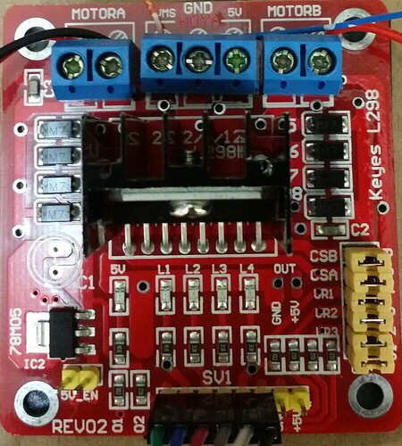

You haven't said what the board part number is although you linked to a pic- have you read its datasheet?
Looks to me like there's a 5V input on the left. But you'll need to find out what that 5V source jumper is on the bottom right of the pic.

manor_royal:
Where is the board part number, I will put a photo for the board in the attachment.
YousefAouf:
Beats me.
But Tom George found you the right info for you anyway.
Read that page he linked: the 3rd, 4th and 5th bullets under Hardware Diagram answer your questions. With the jumper on, the 298 logic 5V is supplied via a regulator from Vms. With it off, the logic gets 5V from what you supply at the 5V terminal at the left. That could be from Arduino 5V, or any reliable 5V of your choice.
Aha
But where i should suply the 5v
In the terminal behind VMS or in the pin behind ENB
Take your ohm meter and check to see if those 2 5V pins are connected to each other. Or, put 5V on one and see if the other measures 5V too. I suspect they're electrically the same point. Probably just for your convenience: one a header pin and one a screw terminal so you have some flexibility in connection.
But the pic you just posted is not the same board as the one you posted in the first post. The first one doesn't have 5V next to ENB, and doesn't say "Keyes" on it.
Just because boards use the same underlying chip, doesn't mean they work exactly the same once a manufacturer surrounds it with other electronics.
Make up your mind which product you have, and go to the manufacturer's site and read the instructions.
The last one is the one that I have
YousefAouf:
So I have to wonder why you posted a different one almost a full day ago (and for which another member hunted down a page with all the answers).
But anyway, it says "Keyes L298" and "Rev02" on it: go see what Keyes has to say about hooking it up.
This guy used Vms for your Keyes board logic, with the jumper on.
So if you want to use a separate 5V the implication is to take the jumper off, like it is in your last photo. But as I said, it's easy to see if the 5V next to Vms and the 5V next to ENB are electrically connected.
(Easy if you have a meter....)
