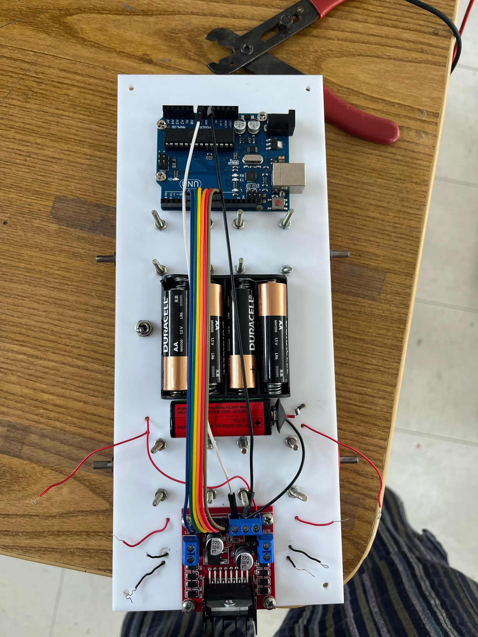

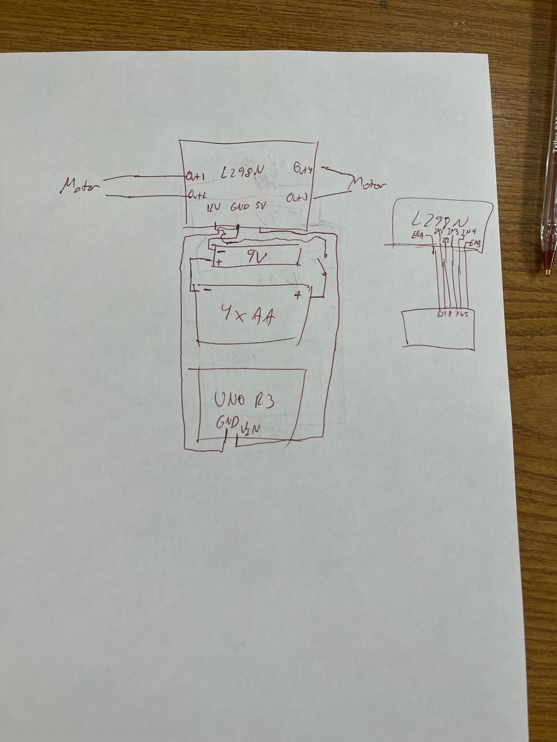

I am trying to create an RC car project. I currently have an L298N connected to two motors (ignore the extra wires, I was originally hoping to make it four), an R3 clone (not sure of the brand), 4 double A batteries, and a 9V battery in series.
(Motors are currently not connected to the driver)
When no motor connects, the voltage across the outs is about 14V. Connecting a motor on the left side works sometimes and the drop is about 7V. As soon as I connect one on the right while the left is running, neither works and the left stops working for a bit, even after I disconnect the right one again. When I connect the right (whether on its own or when the left is running) the voltage across the OUT terminals drops to 0V. I measured the current when one motor was working to be 2.7A, which I found odd given the L298N's supposed 2A limit.
My motors are RE280 motors, specifically Como Drills 918D1001/1 motors, https://mfacomodrills.com/pdfs/918D%20series.pdf .
Any help is appreciated, I have considered changing motors, changing driver, changing batteries but don't want to do any without knowing what the issue is.

Basically your battery providing the power is rubbish. Most 9V square batteries are no good for providing power for any length of time.
The project also needs current, Amperes. The 9 volt cell destroys it all.
Reconsider the powering completely.
Get a power source of some 7.5 volts or more. Use buck boosters creating the motor voltage and the controller 5 volt.
Go for a modern MOSFET based motor controller.
Is taking out the 9V adding more AA batteries a workable solution? Or should I look into another option?
Yes it is.
Would feeding the driver 12V with 8 AA batteries, and powering the arduino from the driver work? I guess that’s not relevant if I’m replacing it with a different driver though. Any suggested drivers or just find any online?
Yes and no. Know that the driver outputs almost all voltage to the motors. The crappy L298 looses 2 - 4 volt so the motor will received 8 to 10 volt! If You use 10 volt motors it's okey.
Some controllers accept 12 volt to Vin but remember that the 5 volt pin can not really be used to supply any current.
6 x AA would often be a better choice.
